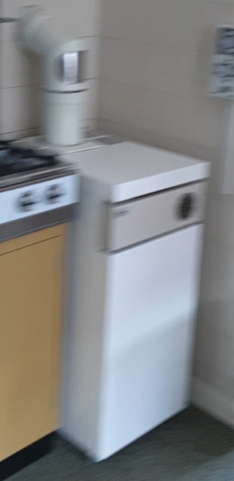

The old boiler has already been removed but I believe it was either a Baxi Boston OF or Boston 2. Can't really check it now as it's been disposed of. Best I've got is a screenshot from a video. I don't have any pictures unfortunately.

OK thanks, just curious. Personally I'm not keen on combis but it seems you've burnt your boats on that score
