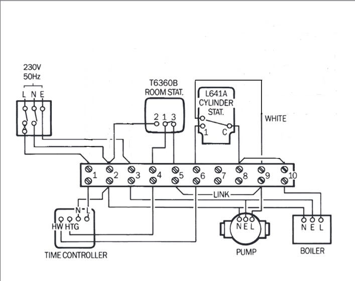

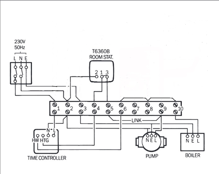

I have a gravity system, it seems there are three versions, C-Plan_old2.jpgC-Plan_old.jpgC-Plan.jpg the first allows no control over the DHW, the second allows one to set summer temperature of DHW, and the third allows both summer and winter setting of DHW temperature, I have the first, but clearly the C Plan can be set up to do all you want.
