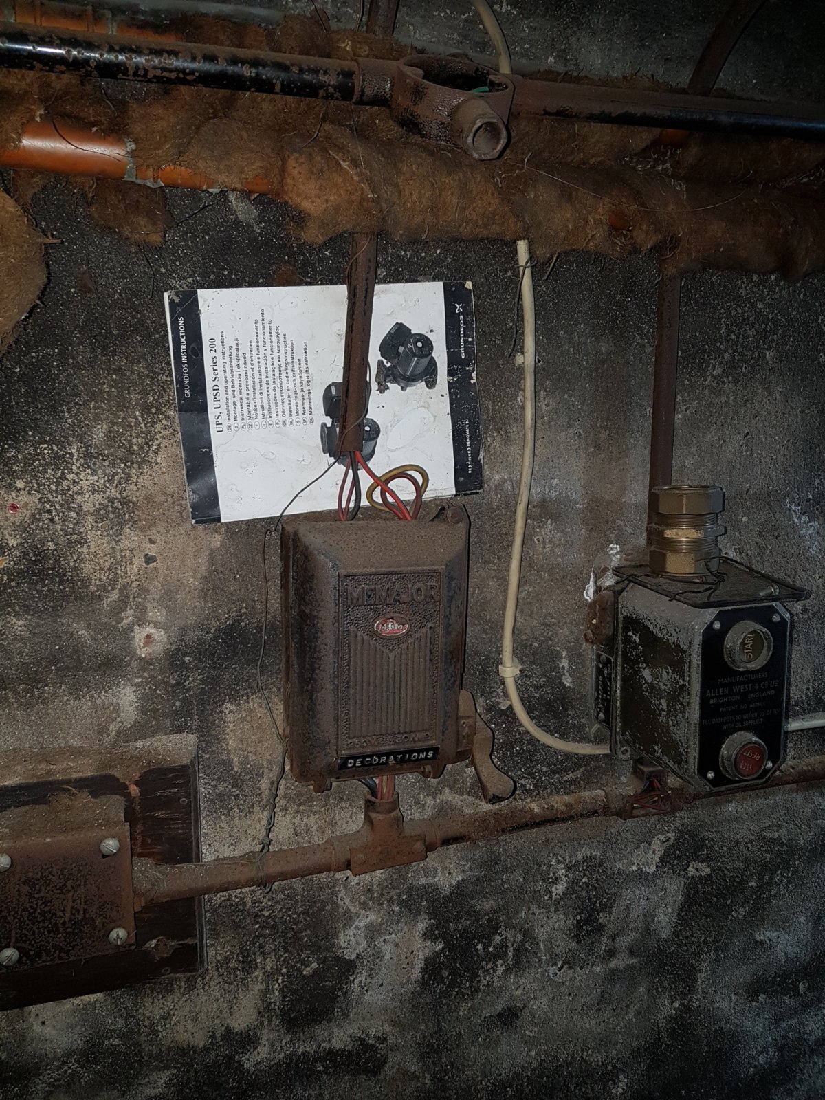

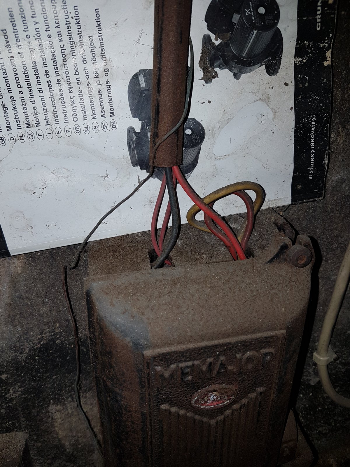

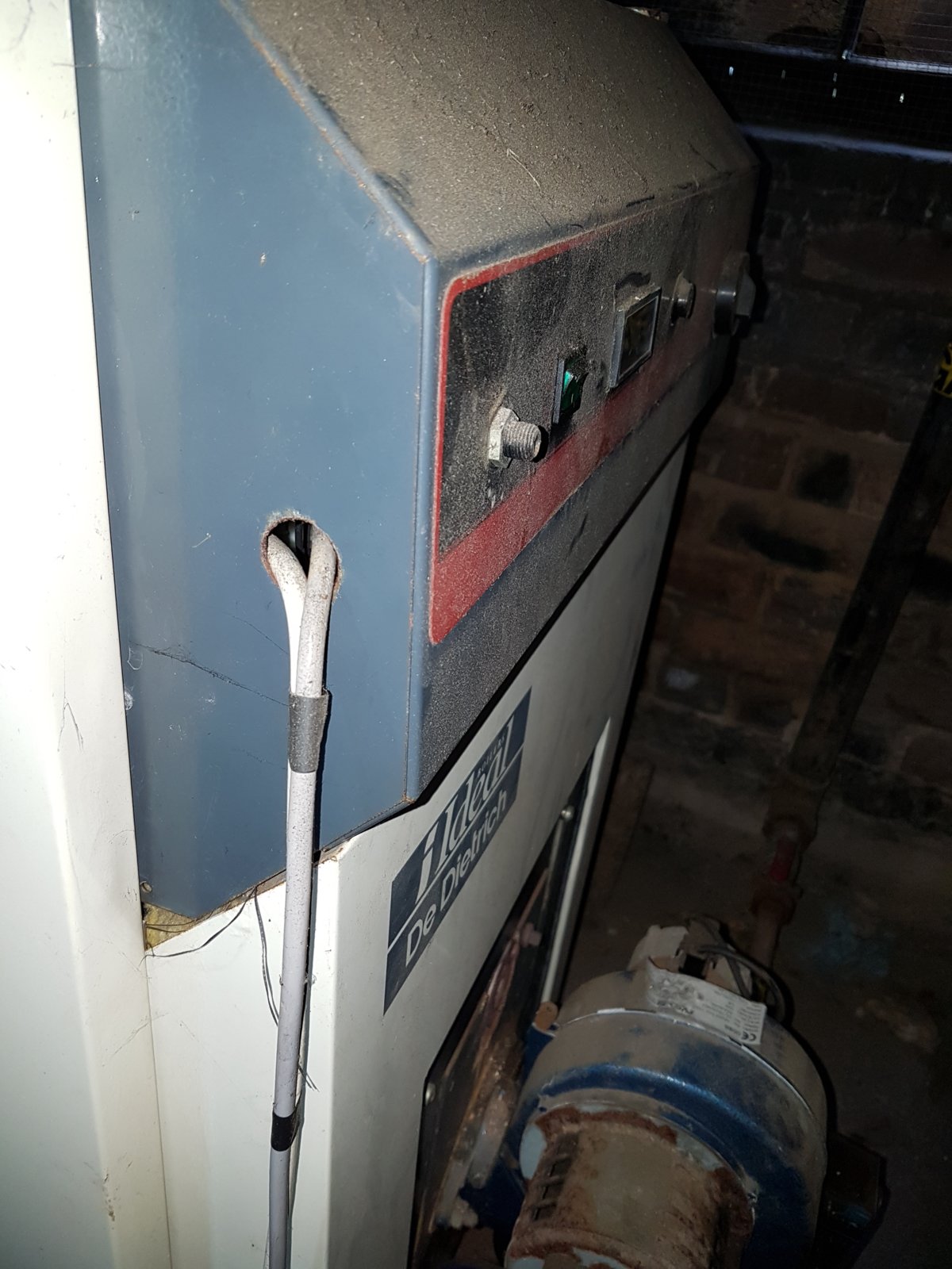

The caretaker at the church I go to phoned me recently as the heating was not working. I ventured into the boiler room and discovered the cable to the pump was broken, I think a squirrel had got in and chewed it. That was an easy fix but I looked at some of the wiring and wonder who would do this sort of work.
I think the photos will give enough information to let you see why I don't think it is a good job. I am going to recommend a EICR and will ask the inspector what he thinks.

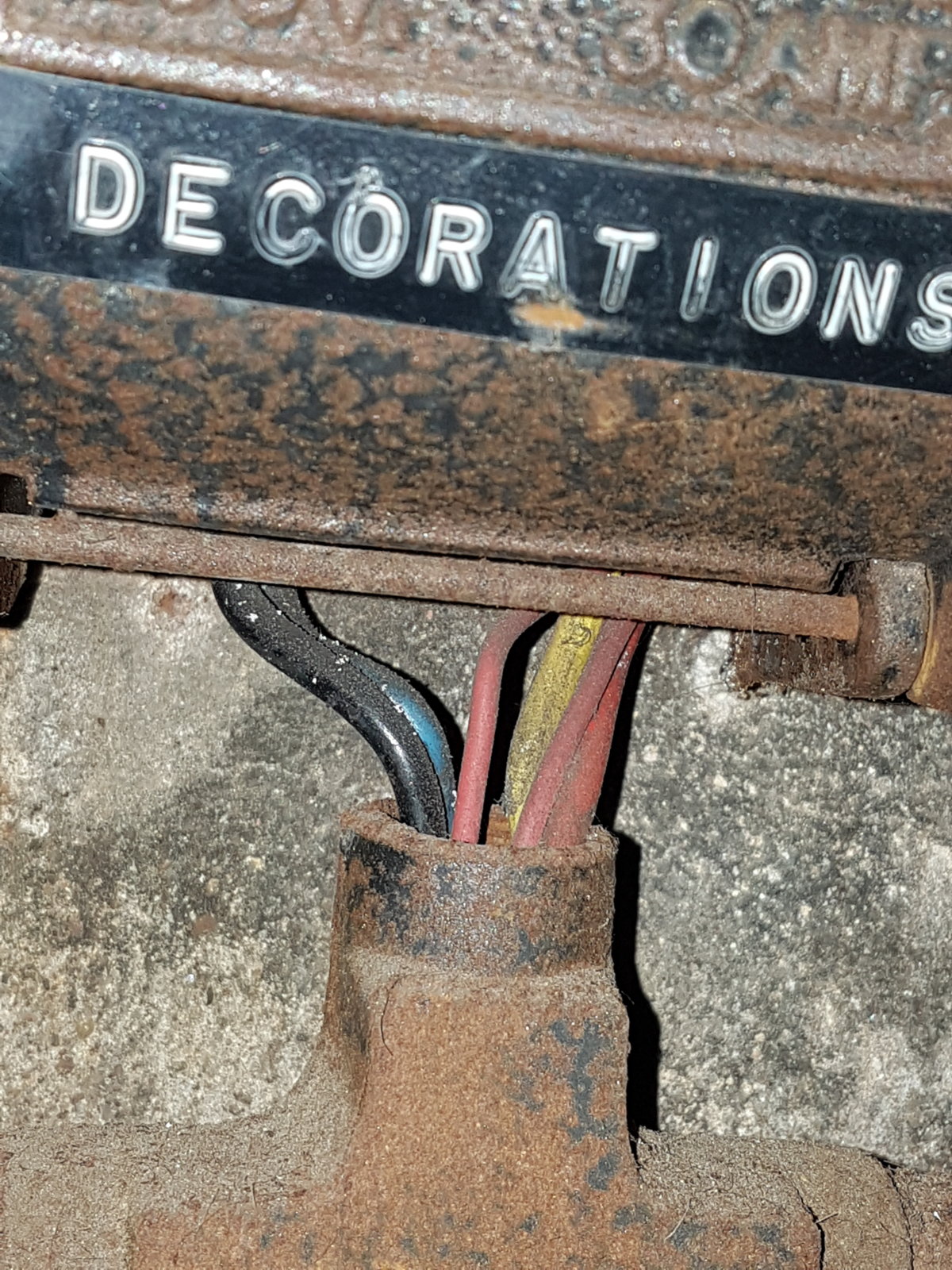

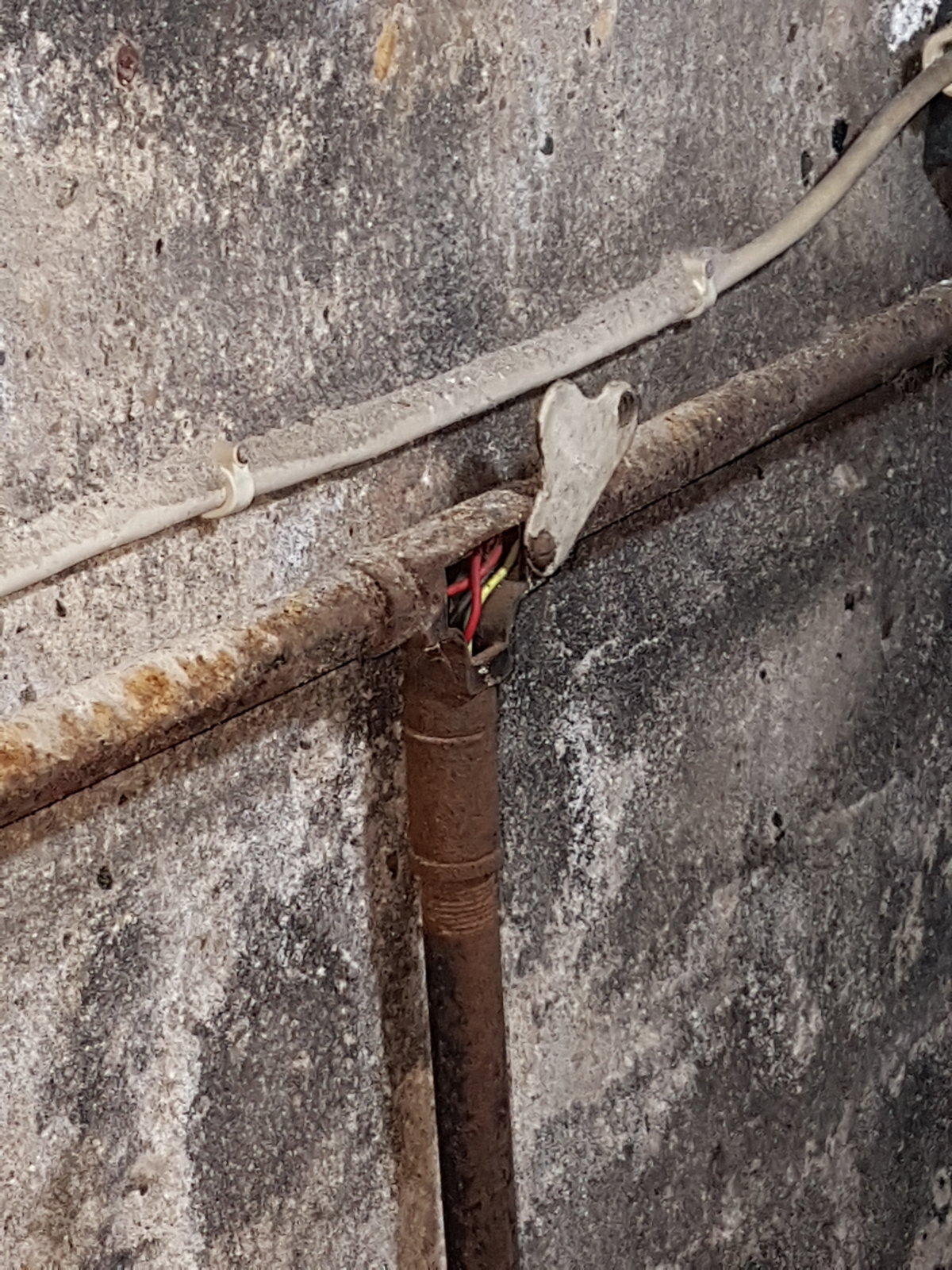

Bang in some grommets and finish off the conduit and jobs a good 'un. Fair play to you for getting stuck in.

It needs a lot more than a few grommets, especially the CPC work, switchgear and conduit completion.
Paying for an EICR would be a waste of money. Get a sparky firm in to do it pro bono or at least give you a price to make things 'good'

If I get the EICR I'll have a bit of paper to back up my opinion that it needs rewired. We need an EICR for our insurance anyway.
I wasn't suggesting you don't get an EICR, I was suggesting you could try badgering them to do it as a charitable donation. Once you have it (paid or for free), there's no going back. Good luck. It'll be interesting to see what it actually says. Please keep us advised.
Given the extreme age and poor condition of the installation, you would be better just getting a quote for replacement.
I't dangerous, but by no means unusual - different people have done "fixes" over the years, and often these people are well meaning but not competent. My guess is that the switch labelled decorations has been replaced at some point, and whoever did it couldn't make the replacement fit the conduit so has just left bare live wires exposed in the gap between the switch and the conduit - and made no attempt to protect the wires with grommets.
If it's anything like our church was (before I sorted it last year), you'll have re-wirable fuses, no RCD protection, "questionable" earthing, lack of physical protection - basically a long list of C1 and C2 defects. Based on the photos and extrapolating, if you get an EICR then you WILL get a "Not Satisfactory" result.

The one good thing is that there is RCD protection. The RCD tripped when a squirrel chewed through a cable which I have now replaced.
