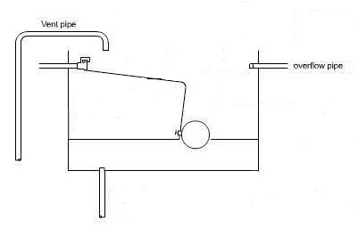

To control any expansion, if your heat only boiler is fed from a feed and expansion cistern, they include capacity for that, an open vent and an overflow to outside.

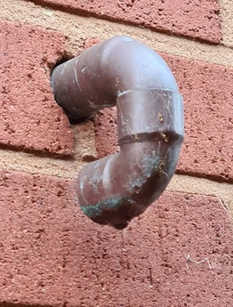

If your heat only boiler is of the 'system' type it will have an expansion vessel and a pressure relief valve that will be vented outside. They normally curve towards the wall to keep any rapidly discharged spurt of hot water away from people who might be passing.
