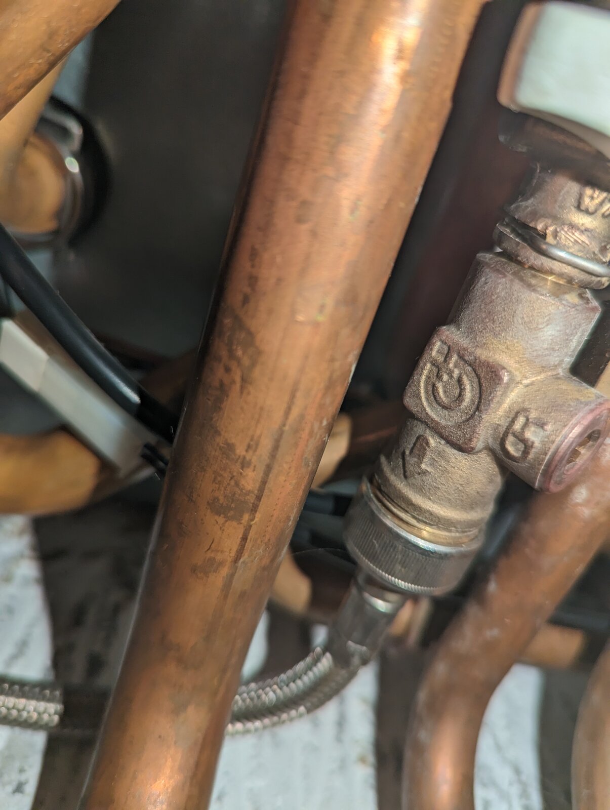

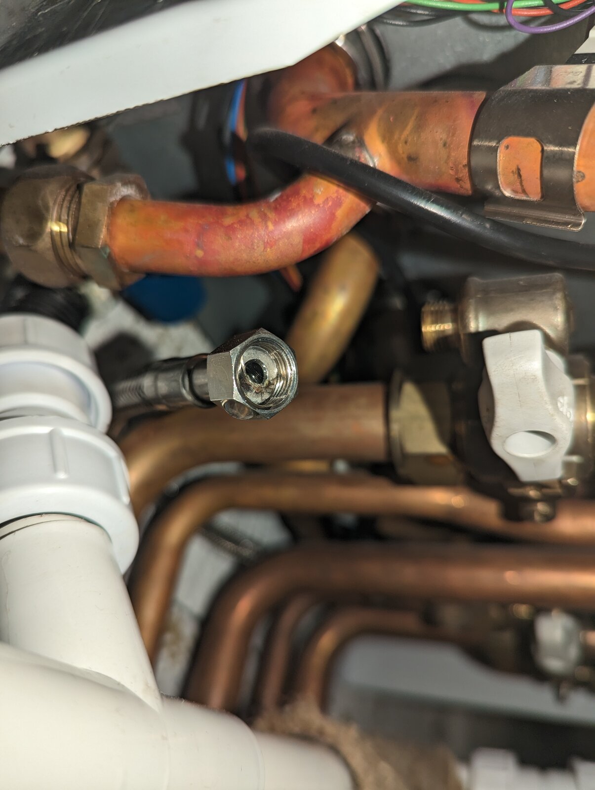

Hey,
I have disconnected the filling loop today and tbh, I think this might actually be the culprit. I disconnected the end that connects to the CH (smaller connection end) rather than the end that connects to the cold water feed.
Both were dripping, the CH side had a small drip from the valve where I disconnected it which when I tightened the grey handle, has seemed to stop but the end that is still connected to the filling loop hose has a very slow but constant drip. I have left it for a few hour hoping it might just be residual water in the pipe but it's definitely continuing.
The problem I have is the access under the boiler is very tight and so replacing the valves is going to be a nightmare.
What options do I have hear and are there any you would advise over the others? Sounds like this is quite a recurring theme on these boilers sadly.
I believe one end of the loop hose is 1/2 in size and the other end is much smaller.
Thanks for all the help so far on this. Really hoping I can sort either myself or get someone in with a specific ask rather than needing them to investigate further.
The filling loop should be disconnected anyway after top up, why not put a blank on the end. If the more important boiler side starts dripping you can probably get a female blank for this.
That is going to be quite difficult as the access is pretty awful. I have read about capping off this loop and doing an external loop to make it easy access wise and remove what appears to be an underlying issue with this boiler. Is that viable? I was looking at this old thread - https://www.diynot.com/diy/threads/valliant-ecotec-filling-loop-leak.401114/ but I am struggling to follow exactly what would be needed. It was for a different model ecotek so that may be why I am struggling.
