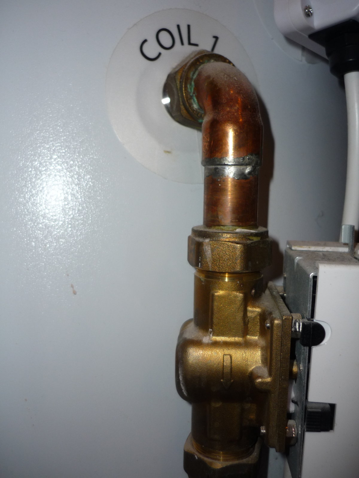

as @Dan Robinson says it sounds like you have a zone valve fitted the wrong way round, the brass body will have a direction arrow on it check that out, your pressure problems are not related, your pressure guage dropping by 0.1 of a bar on startup is normal it is just the pump kicking in

Would I be right in thinking that the arrow on the brass casing in the attached photo should be pointing upwards, so that the water flows into the coil?

They point in the direction of flow. This can be either way depending on the installation.

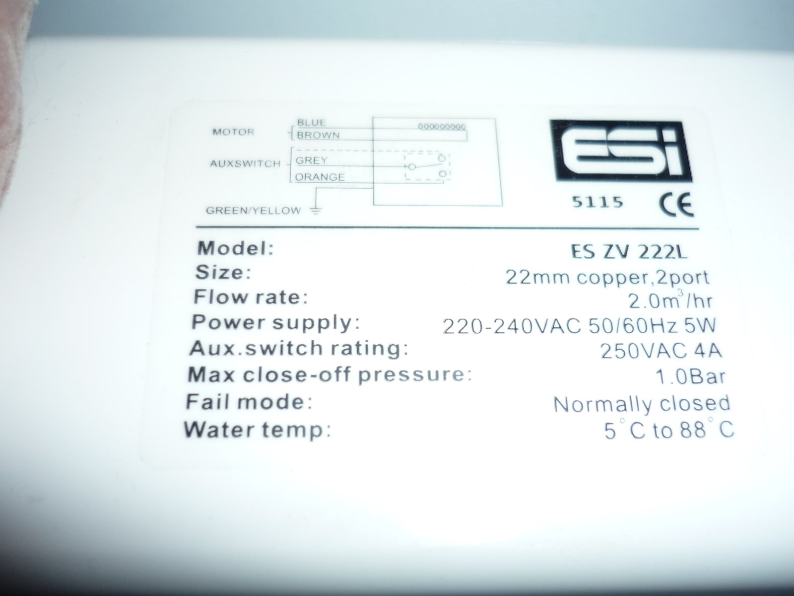

The motorised valve. Is a polypipe honeywell clone they later became branded ESI. They have a faulty switch relay which causes the chattering. Good thing is the head is easily changed the new ones dont have the plug in lead so you would have to put a joint box in wago grey box etc.
I probably changed 50 of them. Got so bad people were binning them and fitting real Honeywells instead.
Plus yours is backwards. By the looks of it.
Port a----port b or follow the arrow

Hi Mr Benchmark,
That's really helpful information, thanks.
I took a picture of the side of the motor box just to check and you're right, it's an ESI product (see file attached).
If I'm honest, I'm not certain if the valve's the right way round or not, but looking at the plumbing, there's another pipe at the same height going into the tank, also marked 'COIL 1'. Just before that comes the Honeywell three-way valve that splits the flow between water and central heating feed and then just before the three way valve is the pump.
This suggests to me that the valve making the noise is at the outlet and hence the valve is fitted the right way round. That said, I'm no expert.
I think if I could have satisfied myself that the only problem was that it was installed the wrong way round, I'd have had a go at turning it round myself. However, it appears the core of the problem is a faulty product and I think I'm out of my depth now, so I think it's time I got a qualified plumber took look at it. Is putting it right a big deal or can it be done without opening the pipes/some sort of drain down?
