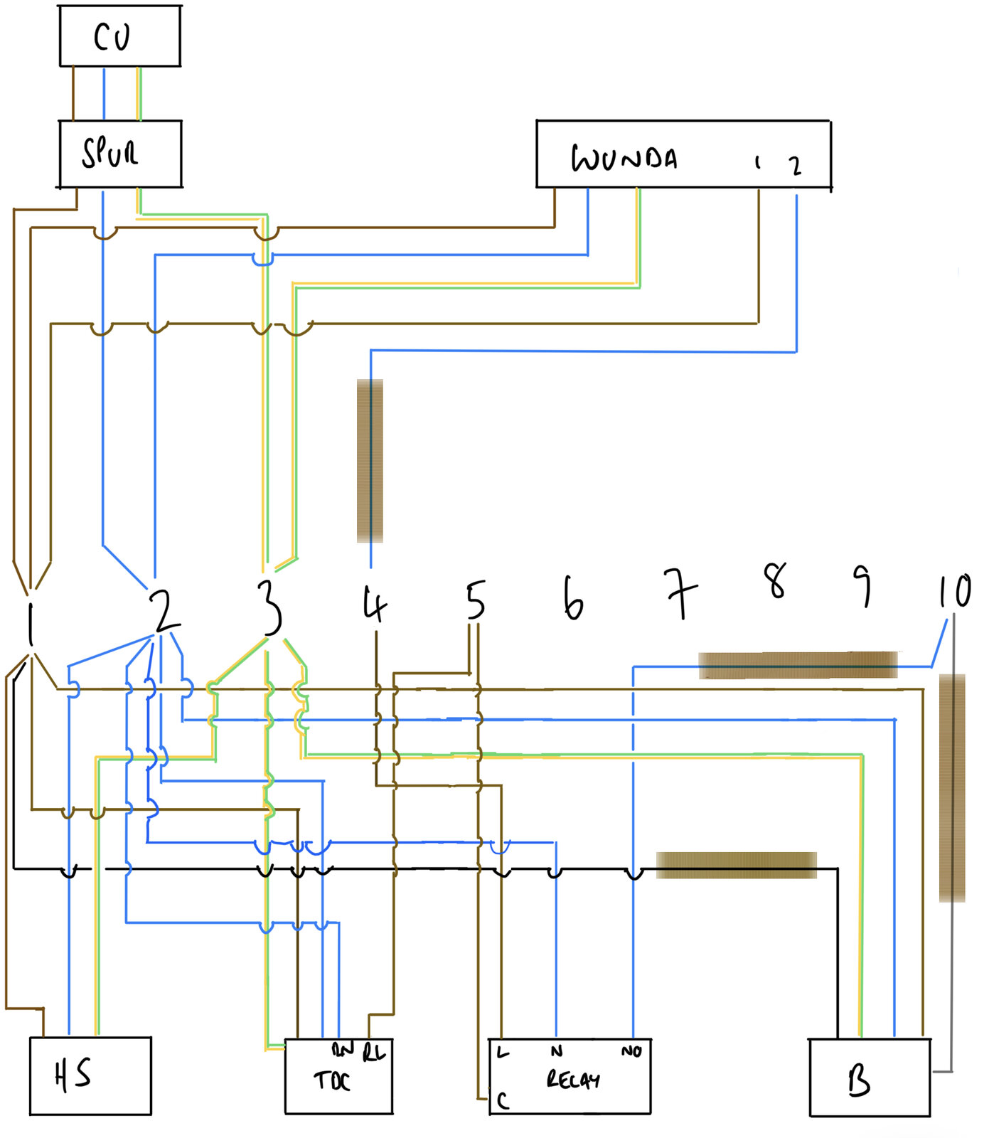

I’ve got a Worcester external oil combi which feeds a buffer vessel which in turn feeds my UFH systems.
On my buffer vessel I have 2 thermostats which monitor the temp of the vessel and this info is displayed on a Grant GSX1 controller. The control is currently set for an on temp of 45° and an off temp of 75°.
When there is a call for heat from the UFH, if the buffer temp is lower then 45° a relay instructs the boiler to fire.
However today I noticed the boiler was firing every 45-60mins and the vessel temp was only dropping to around 63°.
After a quick chat with Worcester technical it would appear this was because the boiler was set to 75° and was reacting to the stat inside the boiler housing on the flow pipe.
Anyone got any ideas how I can get the boiler to react to firing up based on what this controller is reading from the vessel?

Sorry, but doesn't make a lot of sense to me. Would need to see the connections into the boiler control box with the switched live connections identified along with any permanent live connections.
@oilhead
That is the electrical schematics for the S Plan for this system.
Wunda is the UFH controller,
HS is the hub switch which allows the UFH controller and thermostats to connect to the internet,
TDC is the temperature difference controller that monitors the 2 thermostats in the buffer and when the temp is outside of the temps set, send a a signal to the relay to then switch on the boiler - providing there is a call for heat from the Wunda UFH,
Relay is the relay that sends a switch live to the boiler,
and B is the boiler.
so on that a plan,
1 is the lives
2 is the neutrals
3 is the earths
4 is switch live when TDC is outside of temps set
5 is switch live when there is a call for heat from UFH controller,
10 is switch live to turn on boiler when there is a call for heat AND when the temp in the boiler is below the 'on' set point.
As I see that, there are 2 permanent live feeds from the spur. The is the brown one connected to the same terminal on the boiler as the switched live?
