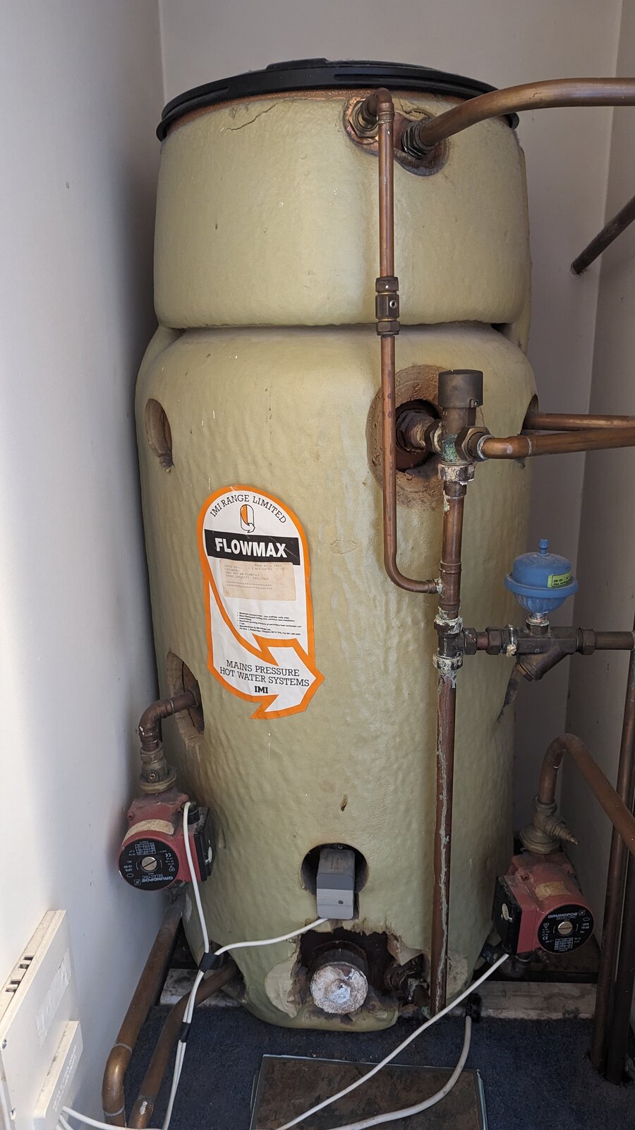

Couple of pics would help greatly
Thanks for the replies so far. Rusty might not be the best description. It does have some around the bottom connections but not the tanks itself. The insulation could use some love though.
Attached a pic, see below. Should have added this from the start, sorry
There is an overflow pipe from the cylinder going outside if that helps. Also appears to have had an immersion element at some point as well but that's been removed/disconnected
That's just a bit of limescale on the unions, due to very slight weeps over the decades - some of mine are like that, I have no concerns.
Yeah previous owner said they had a small drip once or twice which got fixed, but no other issues with it
Out of curiosity how much would it be to replace with a newer cylinder?
Okay, does that change anything in terms of my upgrade options?
Yes your installer needs to understand how a thermal store works in order to pipe it correctly, if it was me quoting I would go for a decent Combi, and do away with the thermal store, or sludge buckets as they are known as.
Not that I usually disagree with other pro's but I'd be tempted to put an unvented in there rather than a combi, to future proof HW delivery for a growing family, everything an unvented needs is there, for it to replace the store.
