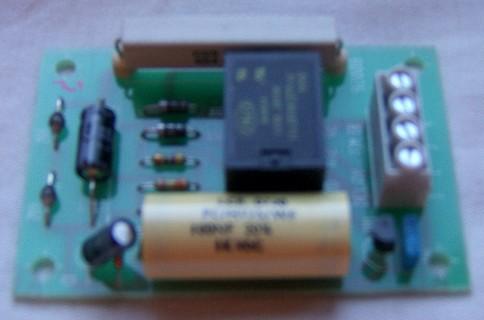

As some of you are aware, I have the Boilermate 2 constantly running pump problem. I've been advised by forum members (thanks - you know who you are) to change the PCB.
Question is which one?
I went to the Pump Drive PCB first and found discolouration from heat scorching on the PCB. I started to undertake some resistance checks and damn near burnt myself on Delay Timer PCB. It turns out that the heat scorching originated from R1 on the Delay Timer PCB. I haven't had time to desolder for proper testing but resorted to a quick voltage check in situ. The right hand leg was at 125v and the left hand was at zero. This can't be right 125v dropped over one resistor, can it?. Does anyone know the R1s component data and value so as I can replace it rather than the whole board?

Thats a fairly hefty resistor and if it's hot it has probably survived so far.
At a guess it is a mains dropper resistor which with the diodes and maybe a zener is supposed to provide a low voltage DC supply for the rest of the board, but that is just a guess.
I would check the diodes and the transistor which presumably switches the relay ON/OFF.
Does the pump connect directly to this board and what are the other connections to it?
EDIT: Just found a block diagram which suggests the Pump Drive PCB is used to control the Heating Pump and the Boiler Pump Delay Timer is connected to the Boiler Pump. Is it the Boiler Pump which runs permanently?
Its the Delay Timer PCB that is constantly providing a voltage directly to the boiler water circulation pump.
I know there is a known fault with the two capicators that is related to relay chattering. I think that R1 is okay, after a little research into wirewound resistors, and the heat scorch is because the pump is always on. If I had a list of components I'd be happy to change them all. The resistors are easy with colour codes but the Diodes are a not apparant.
A board circuit diagram would be handy, wouldn't it. I may have to get the PCB out tonight to photograph it and draw a circuit diagram......

Seems likely that when thermostat supplies power, the resistor/diodes provide DC to charge one of the capacitors and hold ON the transistor and relay driving the pump.
When mains from thermostat disappears the charged capacitor should be just enough to keep the transistor (and relay) powered ON for the overrun period.
Among other things it's possible either the mains power to this board from the thermostat isn't being cut OFF when it's up to temperature, or the transistor has shorted and is holding the relay ON permanently.

Thanks for the info Jack,
I can confirm that the switched live to Timer Delay PCB goes on/off with the neon - working as advertised.
When I switch the system on, after being off for resistance checks, the pump did not run immeadiately. There was a 2-3 second silence, 2-3 second relay chattering and then the pump kicked in - even though the switched live hadn't demanded it.
The track at the top right by the wirewound resistor has continuity.
View media item 7470
View media item 7471
Any ideas?

There isn't that much on the board really. Resistances are high values so it should be straightforward to check the diodes and the transistor in circuit.
If the zener diodes have failed they usually like going short circuit so that should be obvious. Looks like they are marked with an identification number which helps.
Diaster! Just found that I'm getting 42v on the S/L input when should be off. Could it be store thermostat? I'm off to check now!

Gone full circle now! It turns out that the 42v supplying the Timer Delay PCB must be from the boiler. I've isolated the store thermostat to rule that out. Gone back to the Boiler (servicable according to Heat Team) and used the isolator switch to turn off the boiler and find the S/L drops to 0v.
What could cause the Potterton Suprima 40 S/L to be at 42v when off?
