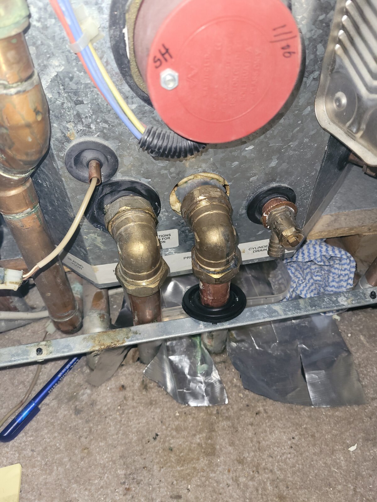

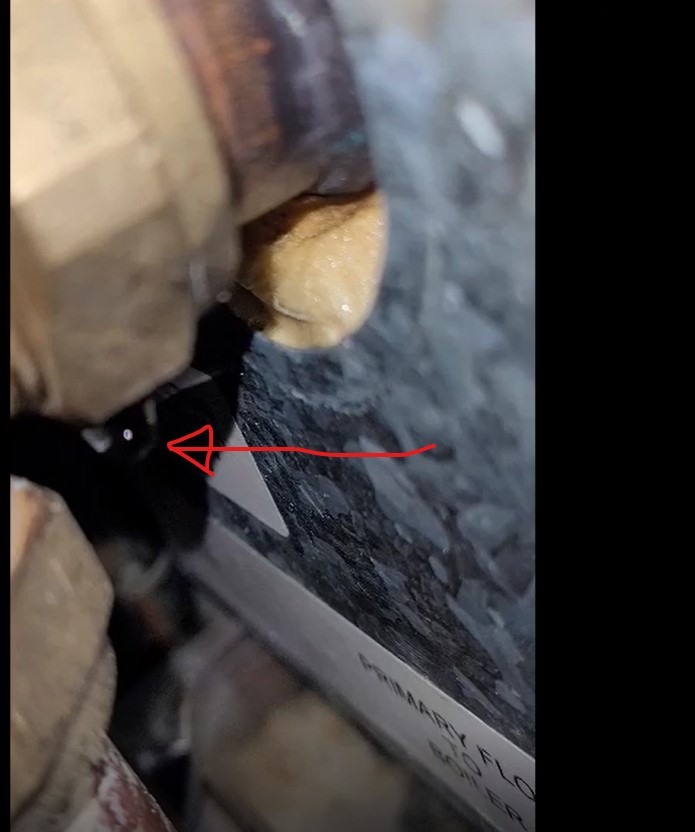

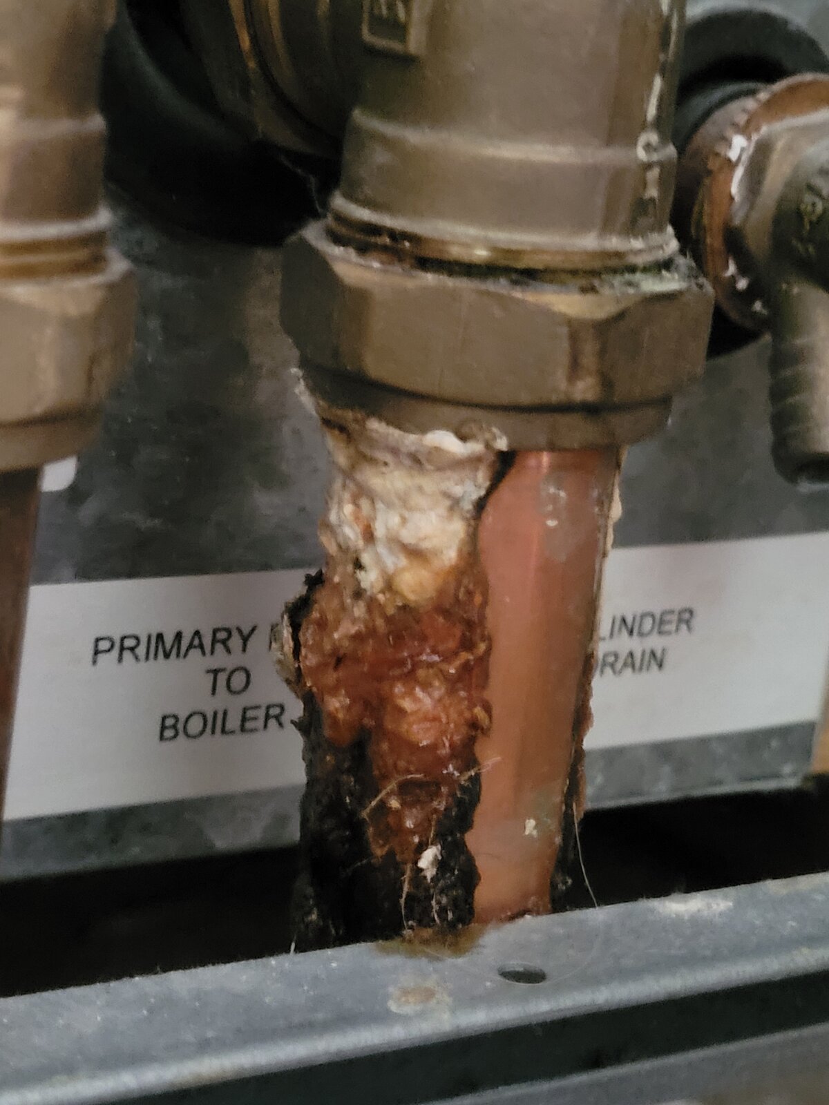

Hi I have a Boilermate in my house and I have had a seeping pipe for a while - At least a year or two (See picture Seeping Pipe).
It seemed to be getting worse, and the pipe had a bit of moisture and with Winter approaching and needing the CH system, I decided to try and sort it out once and for all by nipping it up.
I cleaned all the crud and crust off and tried to get an adjustable spanner on whilst holding the body of the elbow joint, but then the joint started dripping from another part - So I made it worse. (See picture Dripping Joint).

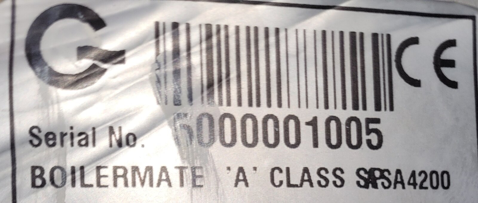

I am not 100% sure what system I have - The label says it is a "Boilermate A Class and what looks like SPSA4200" but I cannot find a 4200 model.

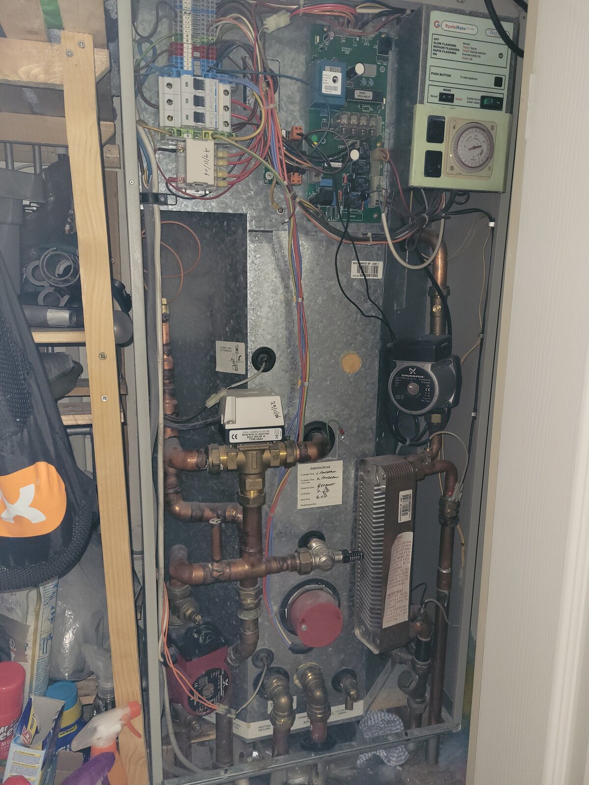

Anyway the devise feeds two levels - 1 radiator in the upstairs with a room stat and then the main loop with all the other radiators.
I think from memory that the upstairs and hallway radiators have no Thermostatic Valves (Something to do with safety).
There is a Red Balloon type vessel with a pressure gauge and a fill point that you can add water. (Someone wrote 1.5 BAR on it).

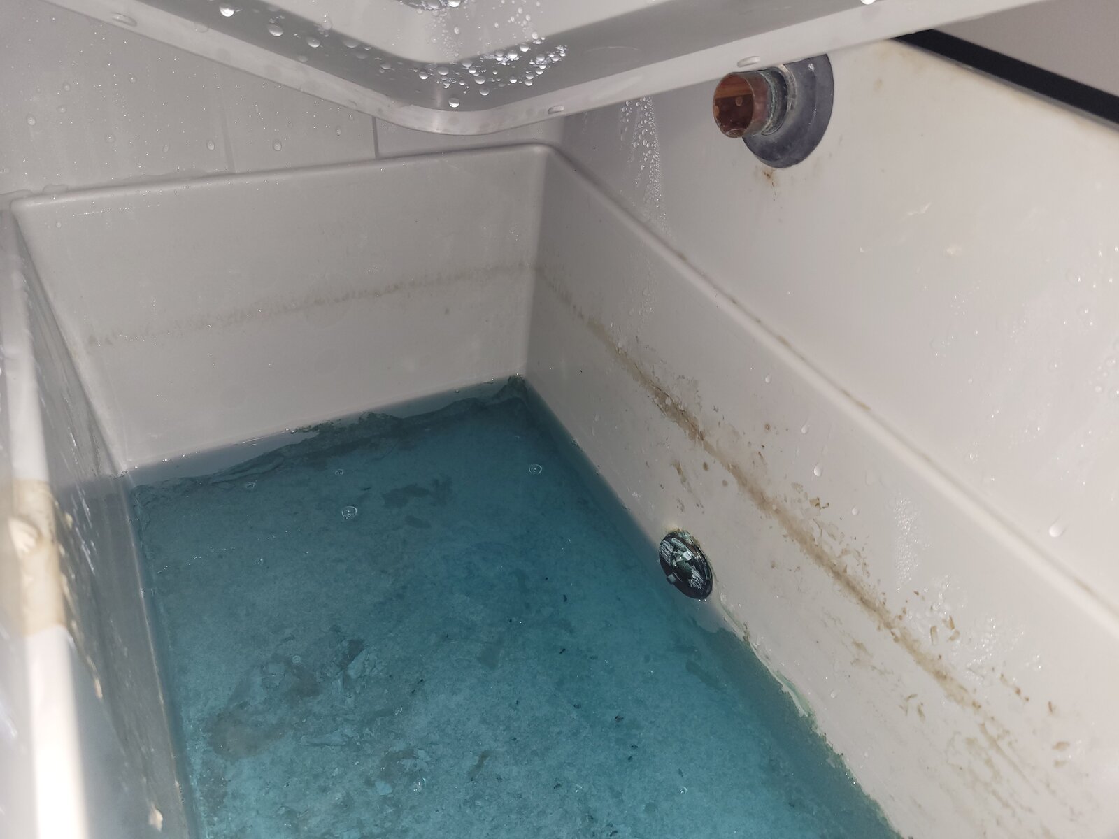

There is an F&E Tank on top which I am sure used to have more water in it (See picture).
I always thought this was an overflow 1 way if there was too much pressure.
The brochure I have shows a ballcock, but I have none.

I know that the Thermal store water circulates via the Boiler and also that my leak is on the Primary Return to the boiler.
There is a drain point on the A Class and also one down by the boiler.
I guess what I want to know is if I open the drain on the A Class will I lose the contents of the Thermal Store only or also all the contents of the radiator.

The thermal store is open vent. Draining it will only drain the store, not the radiators. It's refilled by pouring water into the cistern on the top. There is no ballcock, because it's one of their slightly less expensive models.
Radiators and the boiler circuit are on a sealed pressurised system, which is what the expansion vessel and filing loop are for.
The leaking item is on the pressurised boiler/radiator circuit. At least some of that will need to be drained, possibly all depending on where the radiators are in relation to the leaking part.
Refilling that is via the filling loop near the red expansion vessel.
If you want to add inhibitor, the easiest will be via a radiator or towel rail.
If you get someone to fix it, they can proceed exactly as they would for any normal pressurised sealed boiler/radiator system. The thermal store part is unrelated.

The water in the thermal store is topped up via the F&E tank (I am a little concerned that the level is below the bottom pipe- maybe I have a leak and lost some).
