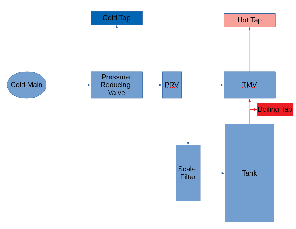

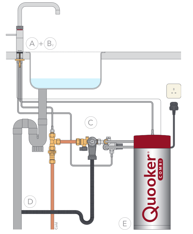

Here is the standard installation diagram for the tap and tank

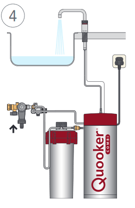

Here is the diagram for where the proprietary scale filter is installed. It only filters the water going to the tank. The water going to the cold tap, and the cold feed to the TMV is not filtered.
So if I use the proprietary solution, then it looks like this as a block diagram.

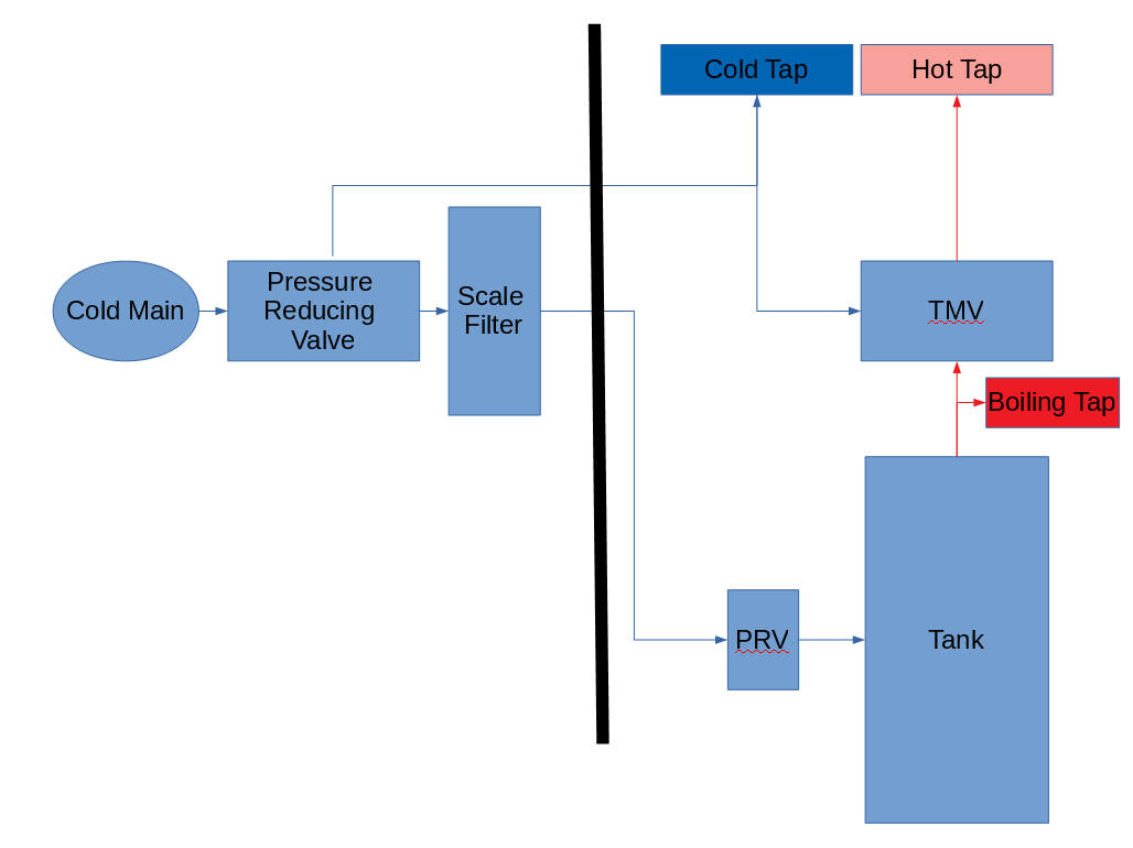

I want to do this instead, where everything to the left of the black line is in the Utility room, and the right hand side is under the sink. That means I have 2 pipes going to the sink, which is fine, because I can use the existing 15mm hot and cold feeds.
Is this still safe with the way the PRV would be connected?
