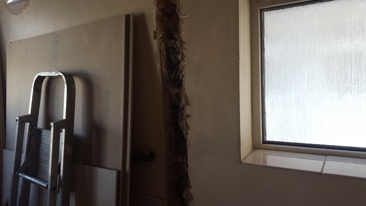

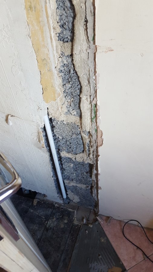

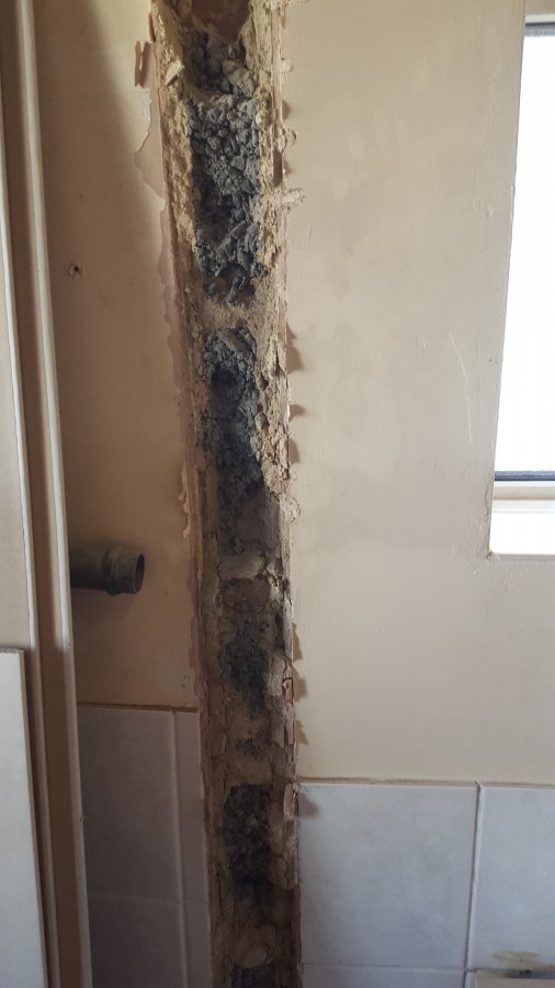

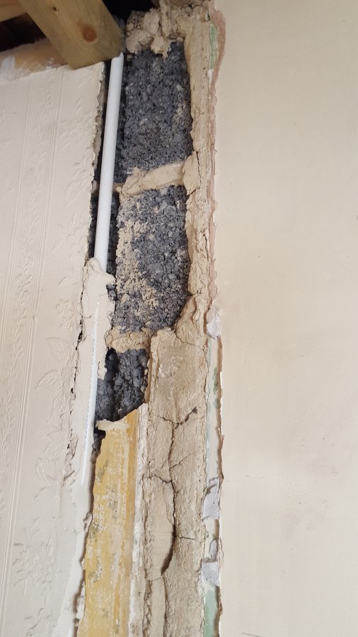

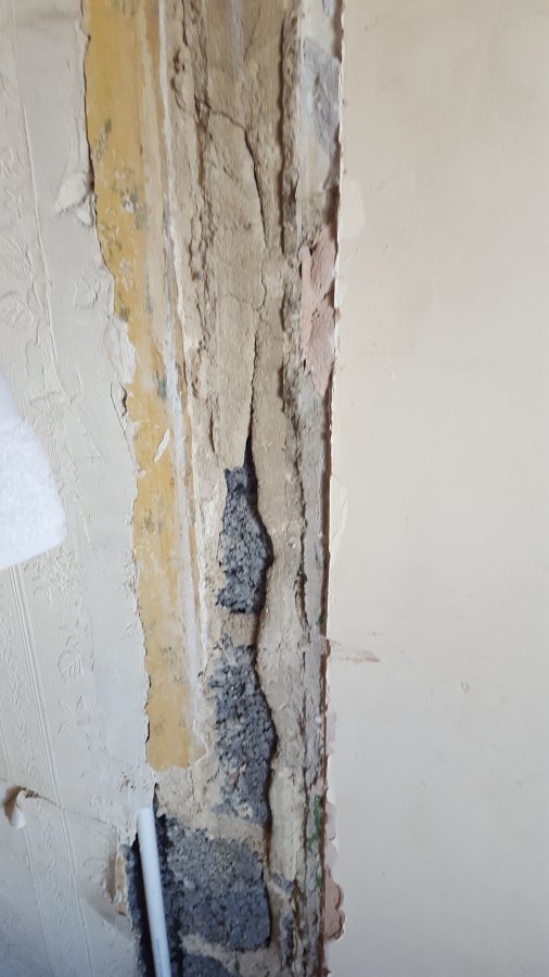

OK here are some pics of the scarring that the removal of the wall has created, there are two of them plus a large chunk out just above one of the windows.

I think the first step is to fill in the scars/gaps. they are quite deep as you can see, what would the best thing be to fill these in with, i can level off whatever i chuck in it but is it possible to screw into whatever i fill it with? Not too sure of what the best thing to fill these gaps with is. Above one of the windows there is a massive hole to which i will be screwing in some timber and then attaching some plasterboard to it but i am not going to easily be able to do this in these gaps where the wall was
Please show more pics of all the walls with the tiles off, and the hole above the window.
The cables running in conduit are vulnerable: altho i think vertical is Regs, its not safe there - if it wont stand proud, you can go over the conduit with metal capping. or move the cable drop to a Regulated safe zone?
The "scars" should be cleaned out back to blockwork. Plumb (drop) lines on either side of the scars and cut into the lines with a knife.
Fill the scars with S&C or browning or whatever is handy - leave shallow, and skim to the cut lines. Presumably, you are intending to re-tile an enlarged bathroom?
All paper should be removed back to plaster. Sand and wash down old plaster. Sand the plaster board.
How has this work been lintelled over? I can see an unsupported two by pinned to something, is there a supported lintel above?
FWIW: remember to paint the ceiling before doing finish work below.
PVA the rough channel then use a weakish 5-1 sand/cement. ...................
