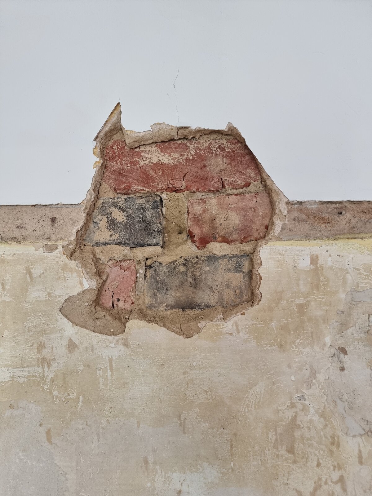

I've attached a pic of a hole from where a picture rail was removed. I have a few similar chunks from when windows got replaced etc. None much bigger than a side plate.
It's a 1920's ish house, original lathe and hair plaster ceilings etc. Assume lime plaster walls.
For this hole (and the others) is this an acceptable fix for a diy'er:
1) remove any loose plaster
2) apply bonding coat to bring close to level and let dry
3) apply toupret filler to level (toupret as I can sand if reqd)
Before applying the bonding coat, do I wet the bricks first? Is dilute pva required first? If so, so I let it go tacky first?
Please advise and many thanks
I'm pragmatic.
House has cavity wall / not solid brick. Bathroom was skimmed in gypsum plaster a decade ago, on top of the lime, with no visible issues.
These holes are upstairs and small (side plate) - the odd gypsum patch won't cause issue.
Plus I have a BQ handy for bonding and own toupret...
What do you suggest re: pva, or, shall.I just wet the brick first?
Silly question but I've not used pva before.
Do I add a dilute mix of pva and water (70% water) and let it go tacky before applying the bonding?
Or do I let it dry?
Or do I let it dry?
Thin the pva down , let it go tacky, then plaster onto it., NEVER ever plaster onto dry pva.
