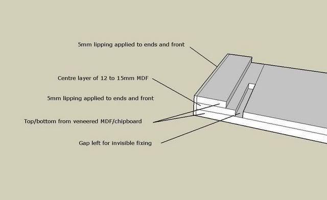

A more "advanced" approach might be to make a "flying " shelf which has no apparent means of support (it is actually supported from the back). Here is a thinner (28mm), shorter example of what I mean, iyt is not supported from the ends:
You could make something similar by making-up a "sandwich" of something like 3 layers of 12mm MDF glued together although if you were to use 2 layers of wood veneered 15mm Contiboard glued around a 12mm layer of MDF and then edged them with matching solid wood lipping (as sold by even B&Q) then you'd get a "wooden" shelf with no visible means of support. The internal structure is a bit like this:
You can buy ready-made wall hangers like these from Hafele:
although a similar arrangement can be fashioned by drilling the wall at 2 to 3 degrees above horizontal and fixing in threaded studding using either Araldite or epoxy mortar. Or if you're not certain then I make these for people to install themselves - and I'm in Lancashire, too. :LOL: (which I suppose makes me a woolly-back......)
