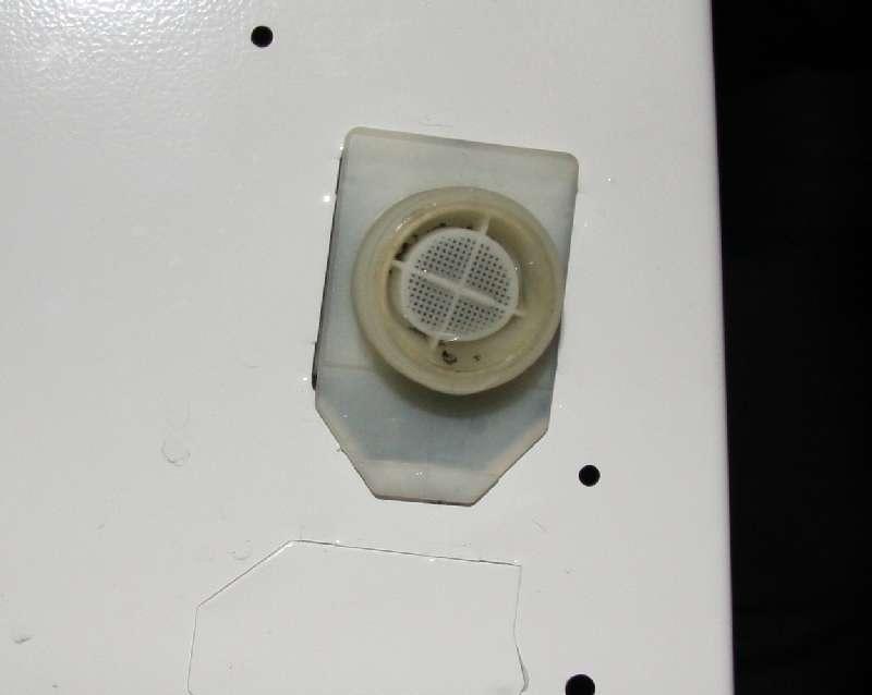

Sorry for digging an old one up but I have just this problem.
I tracked the leak down to the same part, which I need to order, but I can't for the life of me work out how to remove the part from the back of the washing machine. A look on the internet found this site so I thought I'd ask how others have done it, particularly the OP. There's obviously a trick but as I need to use the washing machine before I can replace the part I don't want to rip it out risking damage.

Thanks for the reply breezer. I think I have a slightly different version as there are no screws that I can see. It appears that the housing just locks in to place, I just can't work out how.
I'll try to take a photo tomorrow.

Photo of the back of the washing machine below.
You can just make out through the transparency of the part that it's "oversized" top and bottom on the outside, but on the inside it's "oversized" on both sides. I think it just needs some encouragement in the right direction, just I can't work it out.
Prise the lower part of the valve,the pointed part away from the cabinet and at the same time pull the valve downwards and tilt inwards at the top.
