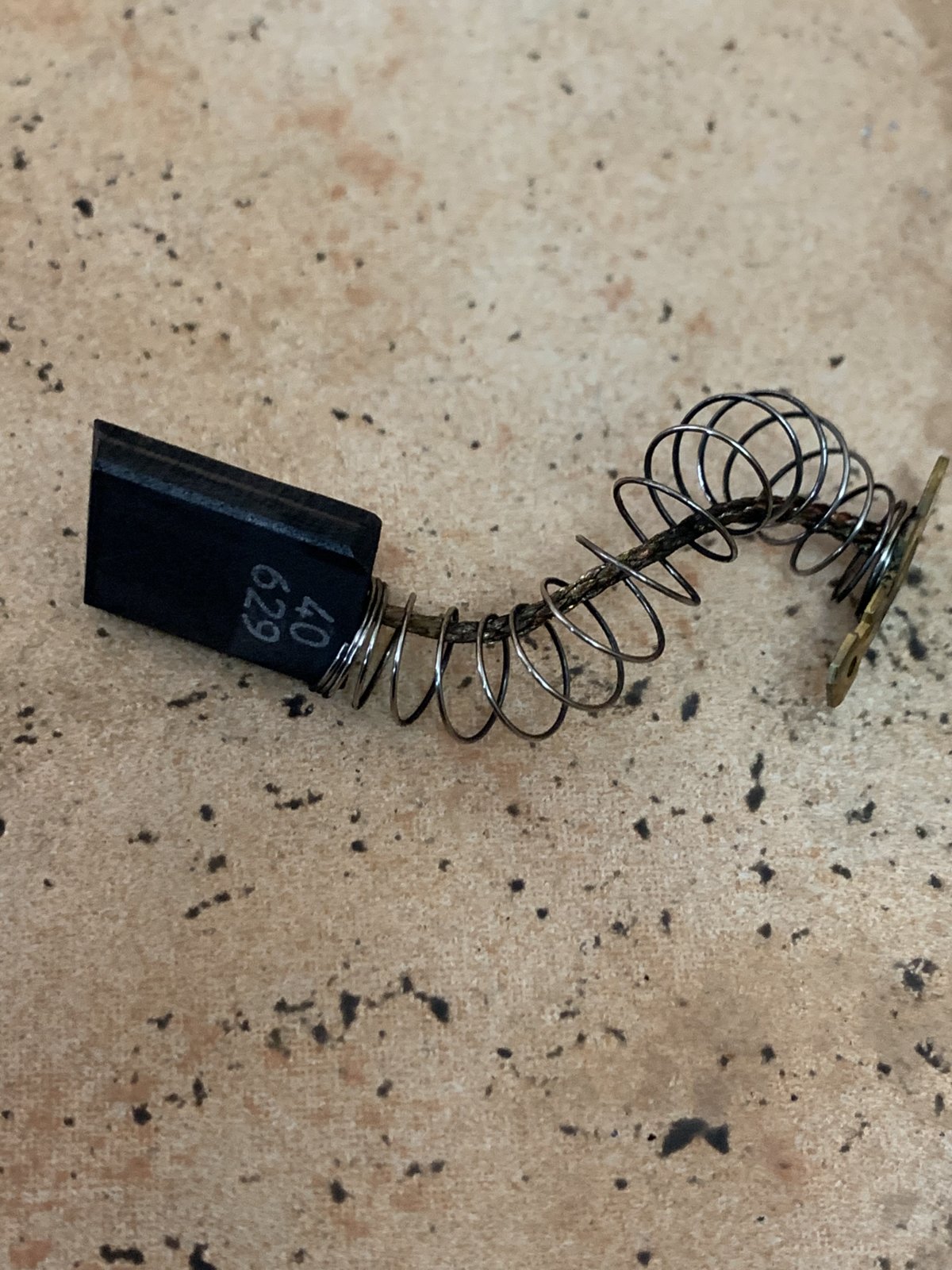

The error codes that I can find suggest a motor problem, so for what it takes I would first check the motor brushes as that is a strong possibility, they should be a minimum of 10mm long & free to move in & out of their holders under spring pressure. If the error will not reset after that then your suggestion of the pub being faulty sounds reasonable, but probably not an economic repair.

Worn brushes can cause some really weird faults. I doubt it is the heating element but just disconnecting it & insulating the wire terminals should rule it in or out if you don't have a multimeter to check for a short or open circuit.
Managed to take out the motor and take a look at one of the brushes. Longer part of the angle is about 18mm long. See photo.
Im guessing it’s is worn down close to its limit but it could have been worse. I haven’t taken the other one out as I realised I will need to remember the angle for replacement brushes.
I’ve ordered the replacement pair as they were fairly cheap and the motor is already out. After swapping the brushes out I will check the heater element if my problem is still not resolved. Should’ve really done this first by simply disconnecting the heater as advised.
