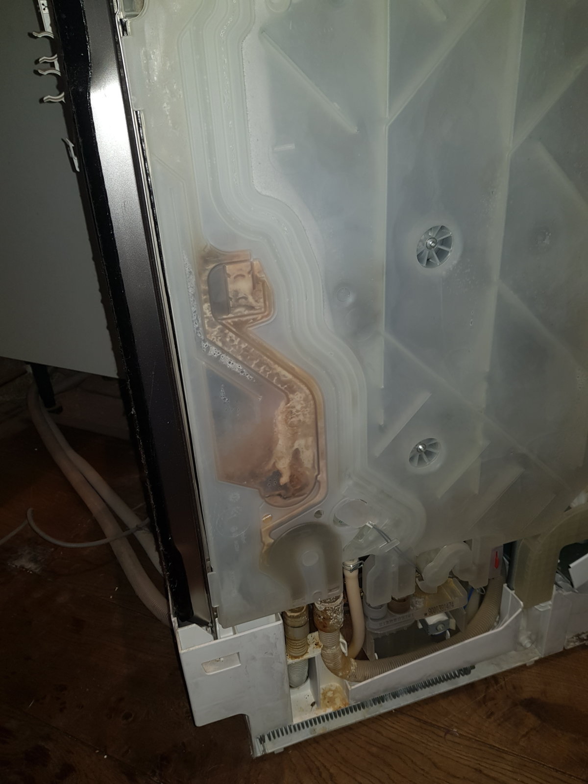

Hello,
My Bosch Dishwasher has decided to start leaking in the bottom, filling up the float area and triggering the E15 error.
After cleaning out the water I believe the water is coming from beneath the coppery/orange chamber in the photo. What is this part? It's quite an old Bosch so need to weigh up whether it's worth buying a new part or scrapping.
Can I access this? Do I need to take the side panel off?
Thanks!
Ben.

Thanks Jules. Appreciate your reply but we're beyond the error code & YouTube stage! :)

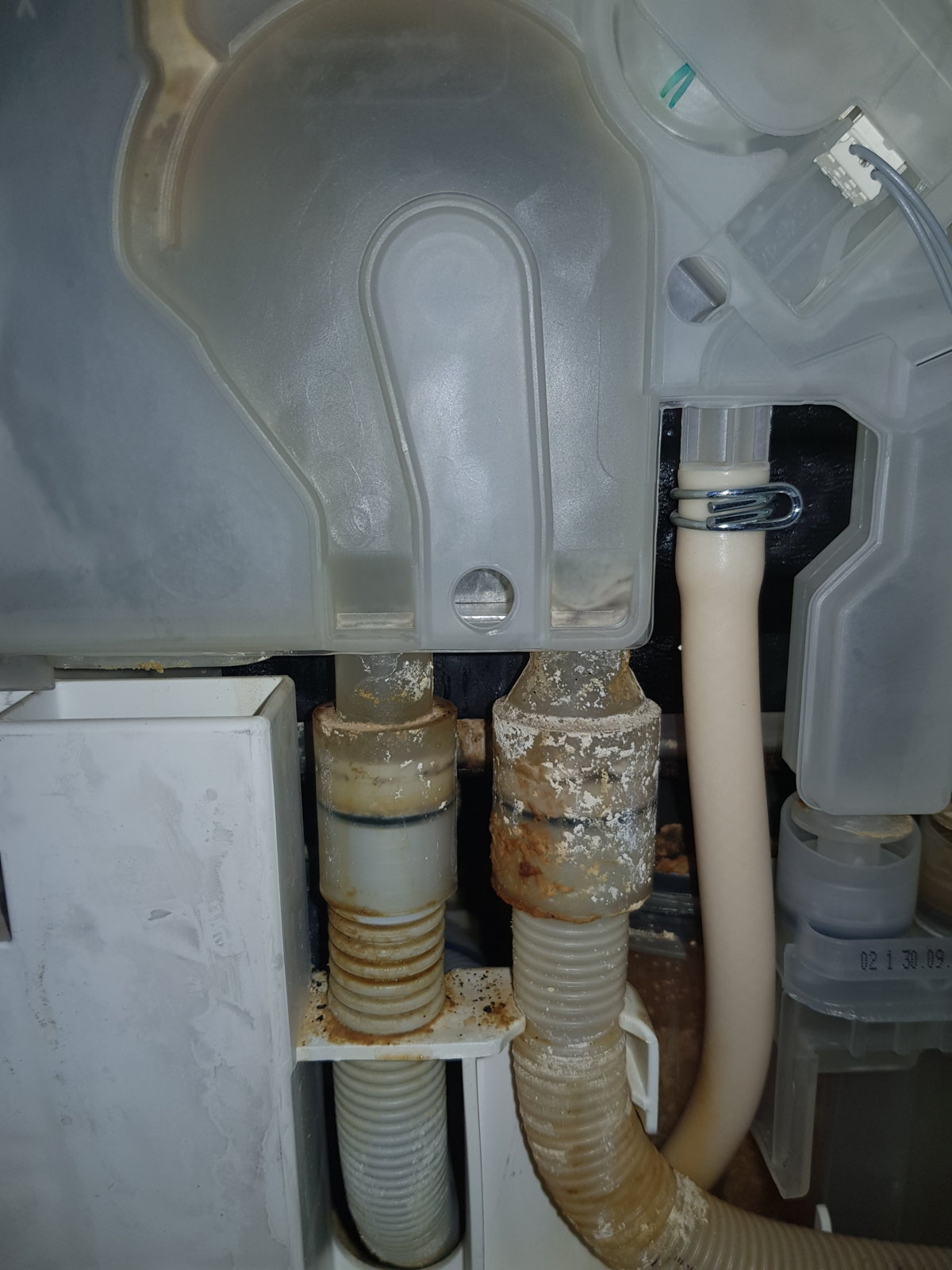

I've taken the side of today and doesn't she look lovely. From any Bosch repairers reading, what would your expert diagnosis be? Is this salvageable? I'm presuming from the limescale buildup around the waste pipes that this is where the leak is coming from. Do you think a simple swap of O-Rings fix it?

Nigel - not sure if you got anywhere with this over the last few weeks, but worth a look at my experience with my Siemens dishwasher which is basically the identical machine internals, and the first leak I found was in this specific area, but the cause was higher up on the back of the plastic manifold so it couldn't be seen/fixed without removing it, and the water was just running down the back and onto those pipe connectors. Makes sense if you think about it as the two pipes with the black O rings nearest the gunge in the above photo are a push fit upwards into the manifold so it can't be those leaking as there is gunge above them.
