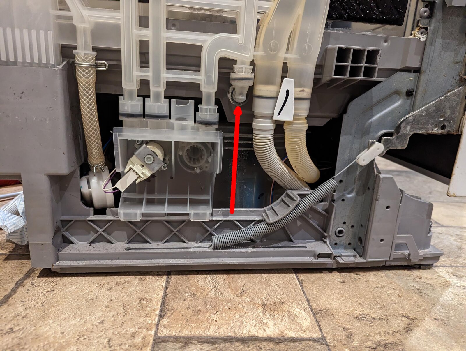

10+ year old Bosch dishwasher.
Have a leak coming from here when the dishwasher fills. Have cleaned but has not resolved the leak.
Suspect O-rings need replacing as they seem a bit loose when I removed this part to clean it.
To get the right size I could do with identifying what this actually does so I can then go and find a part number.
Can anyone assist?
Thank you in advance

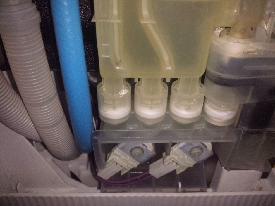

I just had to strip my dishwasher down and replace a few bits so could take a picture. Needless to say, I have no problem with the original o-rings.
This machine is still going strong after over 24 years ish.

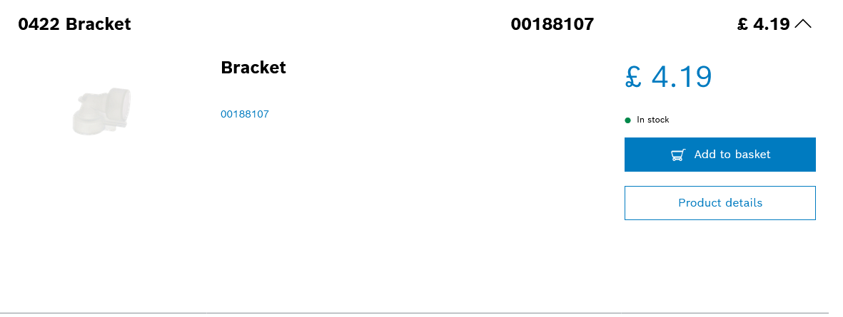

Based on the model number, the part you are pointing at comes back as this....
Screenshot 2023-11-23 at 03-28-29 Bosch spare parts & accessories for your appliance Bosch - S...png
But if that bracket/spigot is removable, and it is the washers that are causing the weep. My above method will work.

Let me know if you find it tricky, I can show more details. The tape can twist and stick to itself.
Also, if you wrap a turn or two around the prong, when you slide the o-ring onto it, twist it in the direction you wound the tape, That way it doesn't just push/bunch the tape up or make it come off. It does not matter if it bunches up a bit.
Also ensure you push/twist the o-rings right up the prongs as far as they can go.
A bit finicky to do first try, but very effective.
