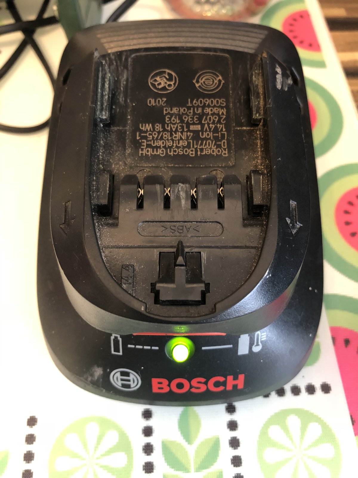

Bought a drill from an auction house, the battery charger had been declared as “do not use” following PAT testing. So I purchased the drill, bought a new charger online & it arrived yesterday.
All appeared to be charging well (green light was flashing, then remained constant).

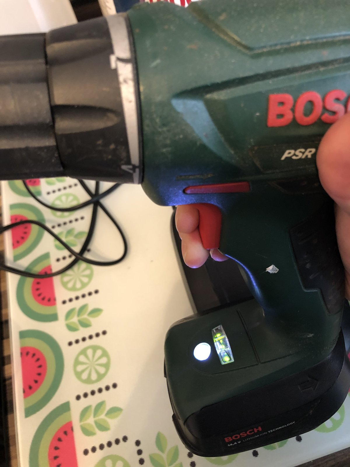

Put the battery in the drill & when I pull the trigger, the white light & all 3 green lights are lit. When I take my finger off the trigger they go off.
Any ideas? I’m absolutely gutted!

About 14 for the auction lot & I bought a second hand charger for 15.

No, nothing happens OTHER THAN the lights coming on & going off!
I wonder if it's the battery rather than the drill? That one's 8 years old. Might be duff battery (ie not enough juice to power drill, just enough to power LEDs)?

When a lithium battery has failed you won't get anything at all out of it, not even enough to power the LEDs.
OP - Seems to me the battery and trigger are working, there's power there to run the LEDs and the trigger turns them on. Leaves me to think it's the motor. I'd open it up and get a multimeter on the pos and neg terminals of the motor then depress the trigger and make sure there is a voltage getting to the motor terminals. If yes, it's the motor. If no, it's the controller PCB.
The motor in these drills is a sealed unit, so you can't replace parts inside it, it's a whole new motor job. Looking at the first result, a replacement will set you back £35 before any postage.
A replacement PCB is £60 before postage.
My advice would be to sell the battery and charger and bin the drill; this is why I never buy tools I can't try first (unless I have protections such as what ebay offer), they're more often than not, duffers.

Simple things first. Do you have it in neutral (locked) rather than forward or reverse? (red switch above and to the left and right of the trigger). If so, this is normal. Move switch one way or the other. Apologies if you know this but not everyone does.
Attached photo shows the directional switch flush with the body and trigger depressed.
