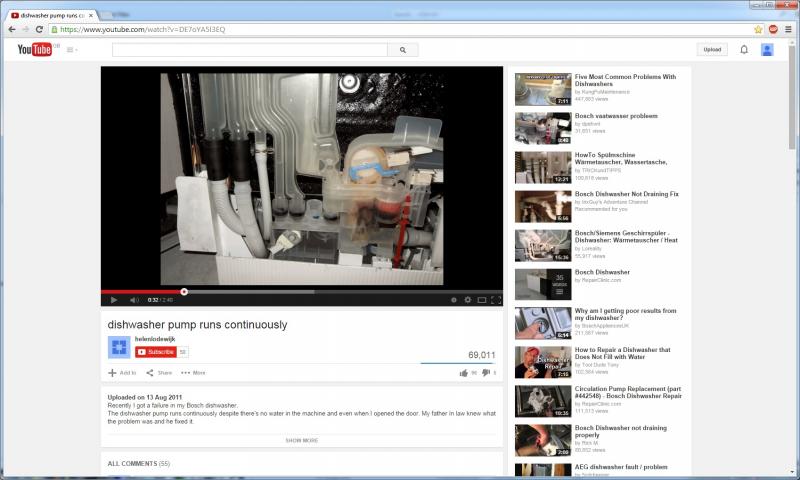

I've got a bosch Exxcel dish washer where the pump kept running, found that the float in the pressure chamber was stuck with lime scale, Taken it all apart and cleaned and the pressure chamber.
The dish washer appears to be working .
There are two parts which concern me.
1. the red rod can not get fully up to operate the pump switch, as the wings on the rod keep catching. If this by design??? can't see why as I thought the idea was to run the pump if overflow was detected in the pan
2. Also i have water in the pan
Can i clip the wing to allow the red rod to move freely, or are they there for a reason?
also should i have any water in the pans or do i have another leak ?
I take it your picture is before cleaning,note the position of the flood protection microswitch and do you have it the right position its probably not seated correctly.
thanks I worked that out late last night while staring at the photo and then realised the pump switch was straight, and now its on an angle and workd, i.e. I have the fixing pins on the left of the switch in the mounting holes and not above the switch.
Now everything works
