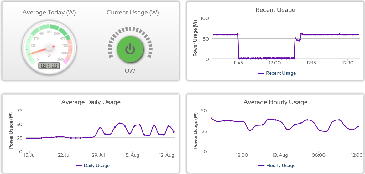

We were lucky we had taken out a maintenance contract, I have an energy monitor that I move around now freezer to freezer, it was on my chest freezer, now on upright freezer. 1723548908113.png bottom left you can see the near straight line for chest freezer, and the sine wave where the auto defrost cuts in with the upright model. Top right you can see how the unit is switching on/off, so average around 35 watts, so that means around an annual use of 306 kWh, the advert says a new one should be around 250 kWh/annum, this is the hottest time of year, and always seems to show using more than it says it should, so seems at 8 year old not doing bad, the energy monitor does seem about the best way to judge how well it is doing.
