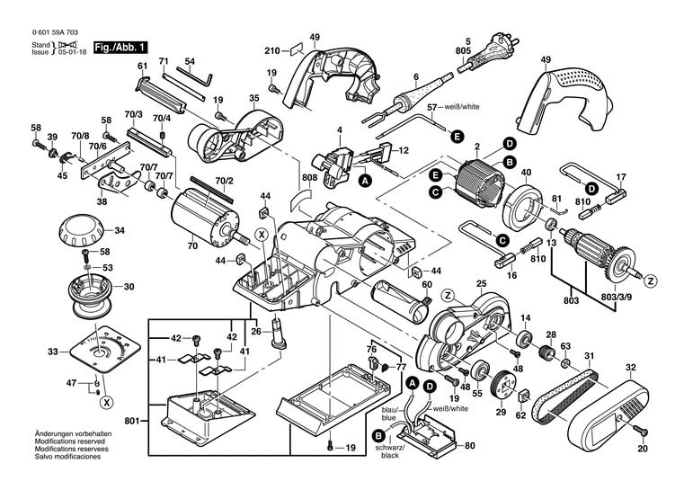

Hello,
I have this model of power plane, it's been good up until Friday when it started becoming impossible to use. I was shooting in doors, turned the planer on set the front of the planer on the door edge and the feed back was extreme vibration throughout the body of the planer. Pushing the planer across the door edge I get a sense that the planer is trying to pull itself backwards whilst vibrating. The product is out of warranty but still in good nick, the blade in it is brand new, so that's not the problem, I've dismantled it and cleaned it that didn't solve it. I reckon the planer barrel thing that holds the blade is the issue, maybe new bearings, but I've no idea how to dismantle this.
Me thinks I should just bin it and buy a Makita, what are you thoughts people??
I think you are absolutely right with your diagnosis.....if you take the belt cover off, remove the belt and grab the pulley on the end of the blade drum you may feel some movement, at least in one end.
Unfortunately almost every screw has to be shifted to dismantle these things so lots can depend on whether you have the time and inclination! The bearings will only be a couple of quid though.
John :)
https://www.sparetoolparts.co.uk/bo...40-82-c-type-060159a703-spare-parts-list.html
My guess would be to replace parts 14, 55 and 70/7
14 is the motor support bearing but it may as well be replaced when the machine is stripped down.
Shifting the blade drum pulley can be a bit of a problem, on some machines both pulleys have to be fixed together.....you can't get the belt on otherwise.
Useful diagram Sammy (y)

My general thinking is if you're going to strip it down to replace one bearing you might as well do them all for what it costs.
Well as it happens, nope I dont have the inclination, but throwing caution to the wind I did as you suggested, but no, no movement all seems rather solid. So i stripped it, cleaned it, regreased it, re-built it, hallelujah it's still broken.
This is my second version of this planer and the last, the previous one was returned under warranty, but the scoundrels at Bosch refused to repair it free of charge as it was their opinion I had planed the wrong material with it "wood" "T*ats....
Makita for me, Bosch can poke it from now on....Thank you for your help John
Interesting- presumably there wasn't any bearing wear?
Just one thing before we leave it, did the motor seem to be spinning at the usual speed?
John :)
Long delay sorry, yes motor seems to be spinning normally, I've still got it, but bought a makita so I can carry on working "yippee' 'that was sarcasm', I'll put it next to my bosch jigsaw that has a switch fault which I may never repair.
