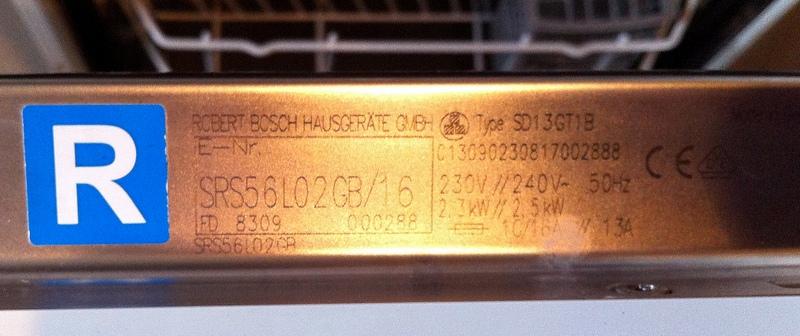

I was hoping to get a bit of advice about this, so that I can try and fix it.
Basically, the machine'd been running fine, until a few days ago, after it finished the washing cycle, upon opening it, I discovered it didn't drain the water. There was a lot of water in the bottom.
This happened a few months back too. I tried using the reset buttons, switched it on and off numerous times, all to no avail. I then called an engineer who said he could come in 2 days. Believe it or not, when he came, and after I haven't touched the machine (with the water still in it) for 2 days, when he switched it on, it drained! Charged me £20 for coming out.
Anyway, it's now happened again. It's now been 2 days, and alas, it's still not draining.
Earlier, I googled this, and found I should remove the plastic bit that protects the pump impeller and see if anything was obstructing that. So I scooped all the water out, then did that (it was a major pain, it wasn't as simple as removing one screw or unclipping something. I ended up removing about 6 screws and still struggled to remove this bit of plastic). It was very awkward, but I couldn't see or feel anything substantial causing the blockage. I tried to see if I could turn this impeller, but I could only feel it with my finger (not see it), and it felt smooth, and I couldn't turn it. I expected some kind of ridges, or something that I could push or rotate with my finger, but I could only feel something smooth (like hard plastic) in there. After this, and cleaning around as best as I could, I put everything back together and run a short program again, and it still won't drain.
I think the pump tries to do it, and I can hear a sucking sound for 3-5 seconds, but it kind of sounds "dry".
Somehow, I have a feeling that possibly nothing is wrong with the machine, and that I might have a blockage somewhere in the drain pipe, or where it joins the sink drain. I should add that any water in the sink itself drains fine.
I've taken a picture of the way all this is hooked up under my sink.
Can someone advise (sorry if this is such a silly question) how I can disconnect this and check for a blockage, without dirty stinky water spurting out everywhere?
Anything else you think I should try?
Many thanks!
