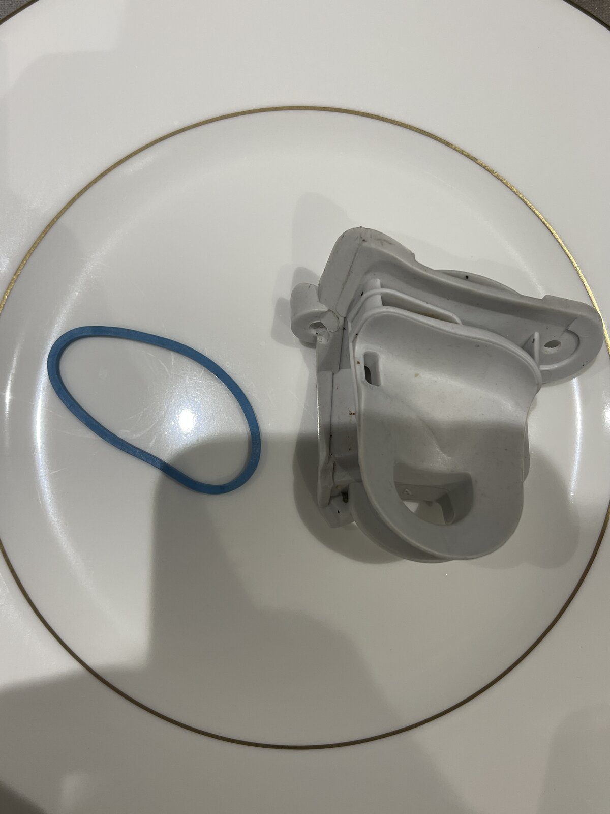

I had an E15 error on my SKS62E32EU compact dishwasher. I’ve drained and just to be sure there’s nothing blocking the impeller I unscrewed the torx screws and removed the pump cover as described on page 47 of the manual.
However, when removing it it has come with a very thin light blue sealing ring. Photos below, any thoughts on how/where it attaches? I thought it might perhaps be an extra one around the impeller but that has its thick black ones. Is it just something that got in there and perhaps was causing the blockage?
I cannot for the life of me find any diagram or replacement part for the machine that comes with anything like it.
put it in the bin it dont belong on it that will be stopping the pump from turning
