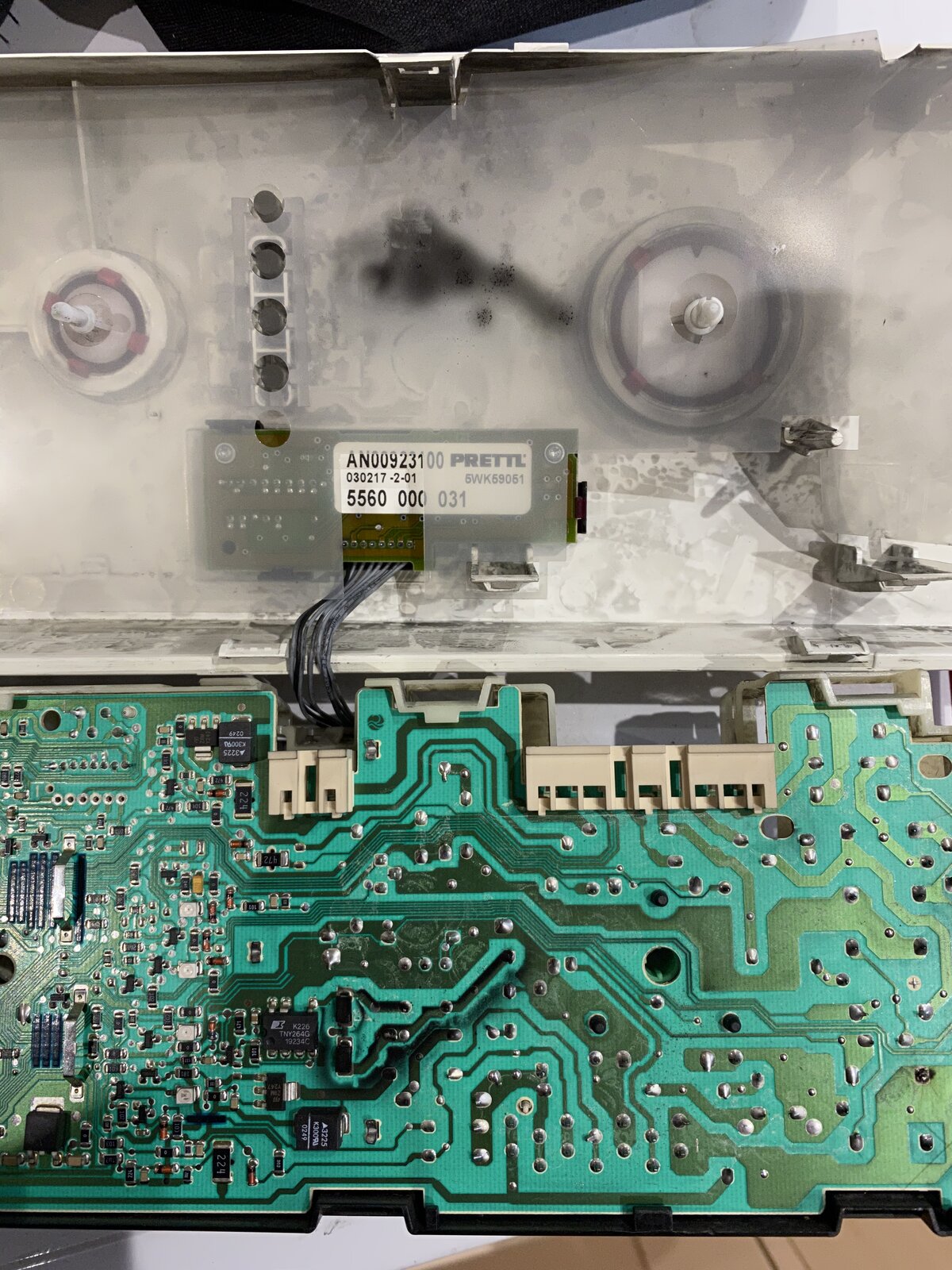

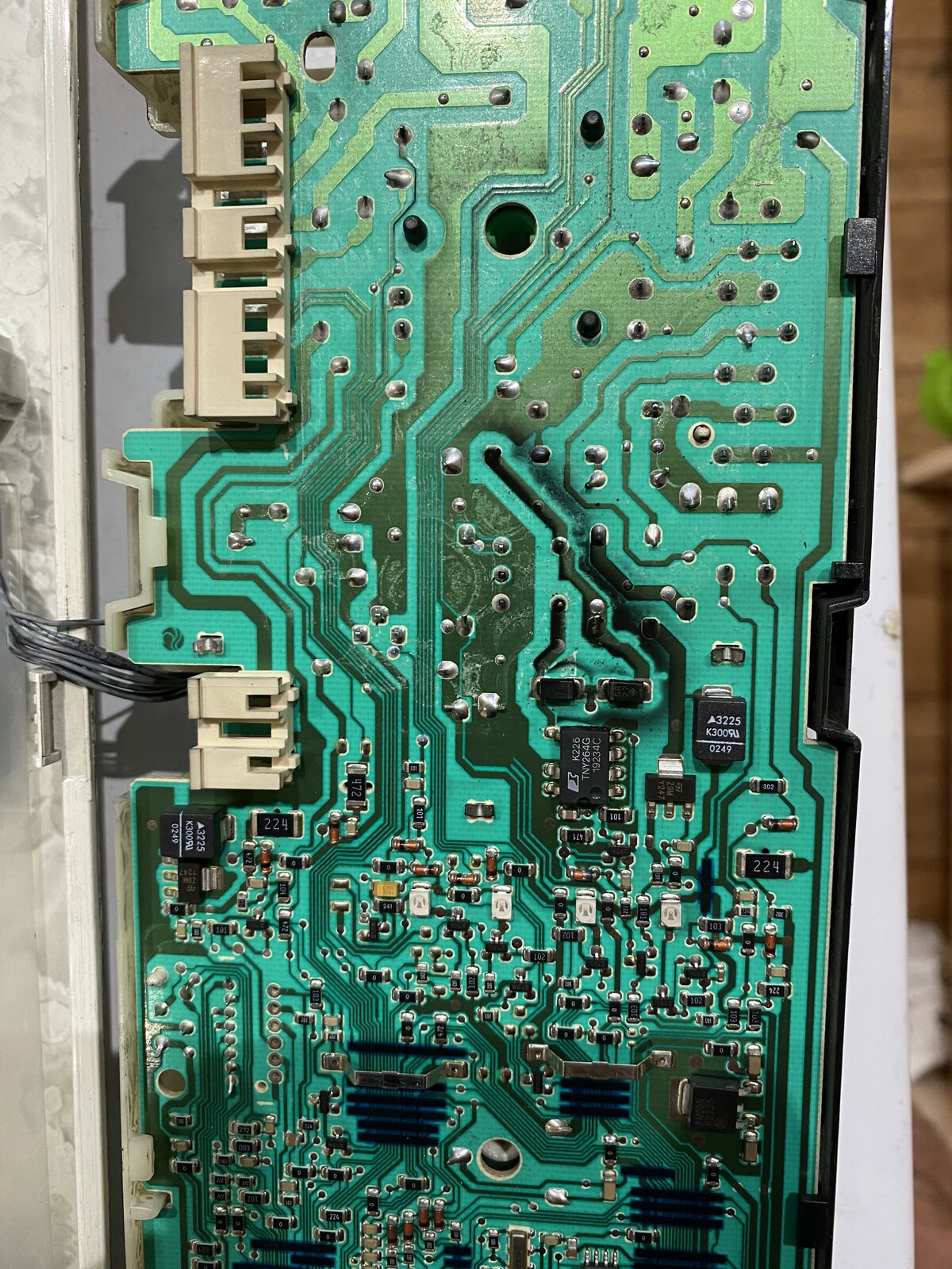

Think I’ve found the culprit...
Is this type of damage normally due to age or is it likely another component caused the board damage? Just wondering how likely it is to happen again and damage a new board.
Mike

Difficult to tell in the photos, but it looks as if some tracks have overheated/ been shorted. You might be able to source a replacement good used board from a machine repairer.
