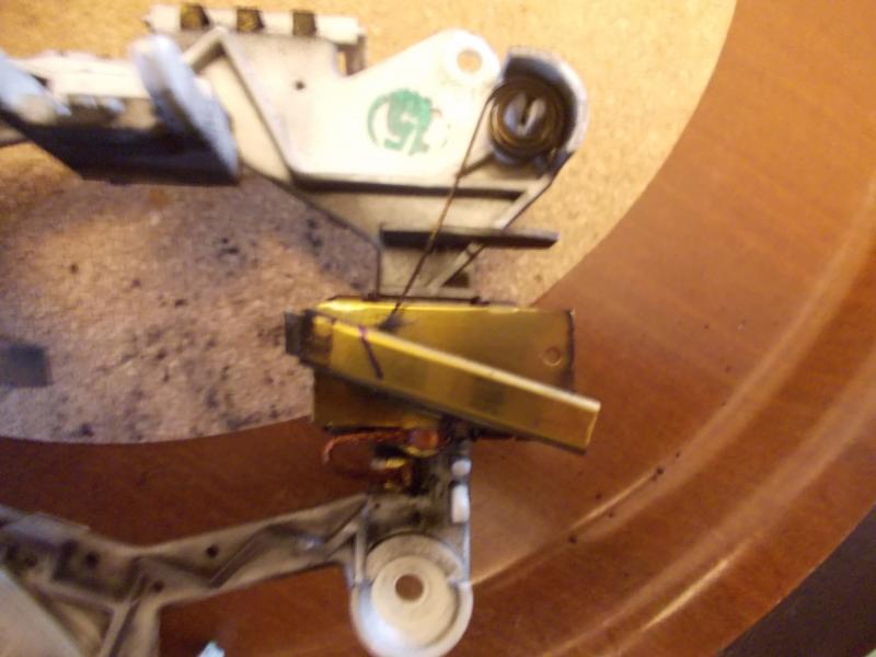

Hopefully someone can help? Got the above washer dryer that is not do anything apart from draining. No matter what program is selected the drun does not turn. Have turned by hand no problems ie physically ok but the machine will not turn the drum no matter what prog is requested(including drying).
PS got a multimeter so any tests no probs
Ps it takes in water for around 10 seconds as well then sops taking in water and nothing else happens
check motor brushes.. you tube bosch motor brushes for guidence, good luck trying to get new ones in.. fiddly!

The old brushes were worn down to around 8mm on one side the other side had around 30mm left. Would this cause the symptoms I have.

New brushes come however what is in there has a separate spring that form part of the plastic housing where the bushes are held in place. Guess where the braid is spot welded onto the buzz bar inside the plastic housing I need to somehow take the spade of the connector dispose of the springs that come with the new brushes or something like that? Any one go any advice?

You can't easily change the brushes on that motor,the correct way is to change the end frame of the motor with the brushes.Part no.496876.
"Easily" sounds like can be done somehow? Even if to effect a temporary repair rather than throw £55 at it only to find something else is wrong. Could I solder the braid to braid as a temporary measure?
Very easy just a solder job. If anything easier than the integral spring type as the spring can be rested on the side of the brush holder than re-assemble and the simply push the loaded spring back onto the brush. Looks easier than the other type where you need to stuff the spring back in the holder.
