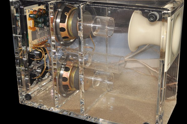

The reason why the sound is a bit 'shouty' are to do mostly with the speakers.
The "direct & reflecting" satellite speakers use a single driver per module (one for each direction) to try to cover quite a wide frequency range. It's obvious that the little modules won't do bass. What's less obvious is that it takes a very good driver to cover midrange and treble without some compromise somewhere. Unfortunately the Bose module drivers aren't that great so they struggle a bit to portray voices and instruments through such a wide frequency range. The result is sound that's a bit strained.
Bass is compromised too. Bose use a pair of relatively small speakers in a ported box to try to fill in from the bottom end of the frequency range up to the point where female voices start. (This is partly because the cubes don't handle mid-range frequencies well). It's a trick used by other sub/sat systems too of course, but not at these sort of price ranges. Because the drivers are relatively small (approx 5.5" diameter) there's a limit in how low they can go. A decent powered subwoofer with a single 8" driver will get down to 35-40Hz. Bigger drivers go deeper. There is a theory that multiple smaller drivers can equal one large driver. In certain cases that's true, but it takes smarter design than the Bose uses to achieve that. What we have then is a sub that sounds a bit limited in range. It's loud enough but lacks the tunefulness of the more conventional alternatives.
The overall result when combining the speakers is something of a hole in the middle of the frequency range where the detail and depth and tone of instruments and voices resides. The common description for this sort of sound is "boom & tizz". At this price range you can do so much better.

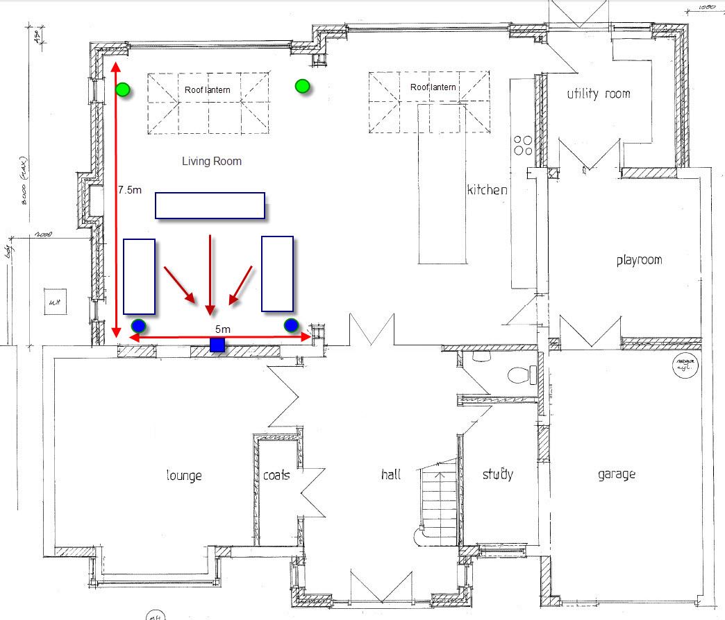

Finally, I've just put the following image together reflecting some of the above information. Would you think this is a good setup of the rear (green) and front (blue) speakers and location of them? The TV will be on the 5m wall.

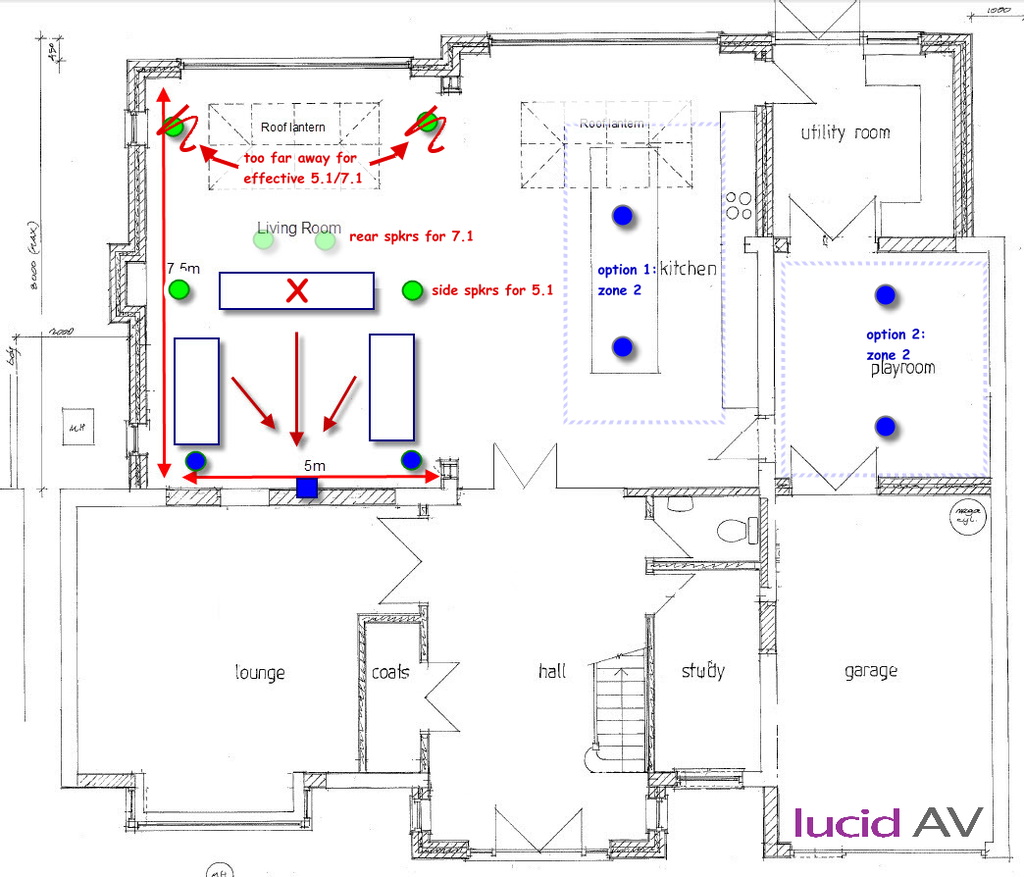

I have had a look at your plan and made a few changes that would make the system perform better and open up a couple of interesting options too.
1) 'rear' speakers moved closer to the viewing area. They were just too far away to be of any use, particularly if they were in-ceiling speakers. The other thing to be aware of is that they aren't rear speakers. Their correct designation is 'Surround speakers - Side'. That's because in every movie sound mixing studio in the world the surround effects speakers for 5.1 are located either side of the prime listening position (in your case this is marked with an X on the plan) rather than directly behind it.
2) Don't go 7.1: With the area being open plan I think 7.1 would be wasted. This is why I have shown 'Surround speakers - Rear' as ghosted. It would be far more effective to take the budget you'd spend on two sets of surround effects speakers and combine it to purchase one pair of really good dipole speakers. These will give the sort of diffuse and enveloping effects sound that will send goosebumps up your arms and have you looking over your shoulder to see who is there.
3) Mix and match speaker types: Modern AV receivers at £500+ are actually pretty accomplished for music too. They won't replace a good dedicated stereo system, but you will be surprised how good music can sound through a properly thought out and installed AV system. To this end (and if budget and aesthetics allows) have a think about floorstanding front speakers. Invest in the centre speaker to match.
For the surrounds, given the open plan layout of the room then the two sensible options are floorstanders or in-ceilings. Bearing in mind the recommendation of using dipoles in point 2 and the fact that dipole floorstanding speakers don't exist, then the sensible option is in-ceiling dipoles.
4) Other options: At the sort of budget and quality being discussed, you'll find that nearly every AV receiver is a 7.1 design. That means it can be used either as 7.1 in the conventional way, or as a 5.1 amp with the extra remaining two channels dedicated to a different part of the house. This feature is called Zone 2 (marked in blue on the plan). I use this quite regularly for clients who would like music or TV sound somewhere else e.g. a kitchen or bathroom or playroom.
The second zone can be operated completely independently of the main zone. It can be switched on/switched off, volume and source changed, even tune the radio or select streamed music... all without affecting the main 5.1 zone which might be off or doing something else entirely different. Depending on the AV receiver chosen then it's likely that there will be a smart phone app on iOS or Android to control the receiver. This includes independent control of Zone 2, so with your smart phone in hand you could walk in to the kitchen, switch on Z2 and listen to radio or the sound from the TV without having to run the main system. It might be nice to cook in the evening with some music playing, or perhaps when there's a social gathering you can have both zones playing the same thing so that sound is spread evenly around the entertaining areas. Where you have zone 2 is entirely up to you; it's not restricted to indoors. There are weatherproof speakers available that would allow you to have sound outside if that's your wish.
Two other options not shown but worth considering are Zone 3 and Front Height speakers. Zone 3 is exactly what Zone 2 is, but an additional zone. So the amp would have outputs for the main speakers, zone 2 and zone 3. Front Heights is something different. Some of the larger AV receivers with 7.1 or 9.1 speaker outlets have the option to run an additional pair of small speakers above the TV or projection screen. The receiver then uses some clever processing to extend the front channel effects up and to create additional height information. It has the effect of lifting the roof off the room. This is kind of a forerunner to Dolby Atmos except it doesn't require the special films with the Atmos sound track; it works on any source so long as the feature is engaged. A 7.1 receiver with front height option can't then run Zone 2, the reason being that there's only one speaker outputs which are soft selected to be either Z2 or Front Height but not both at the same time. 9.1 receivers are less restricted. It can be possible to have 5.1 + 2ch front height and also still have a spare set of outputs to run Zone 2.
