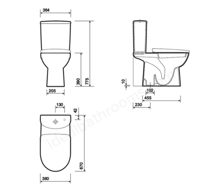

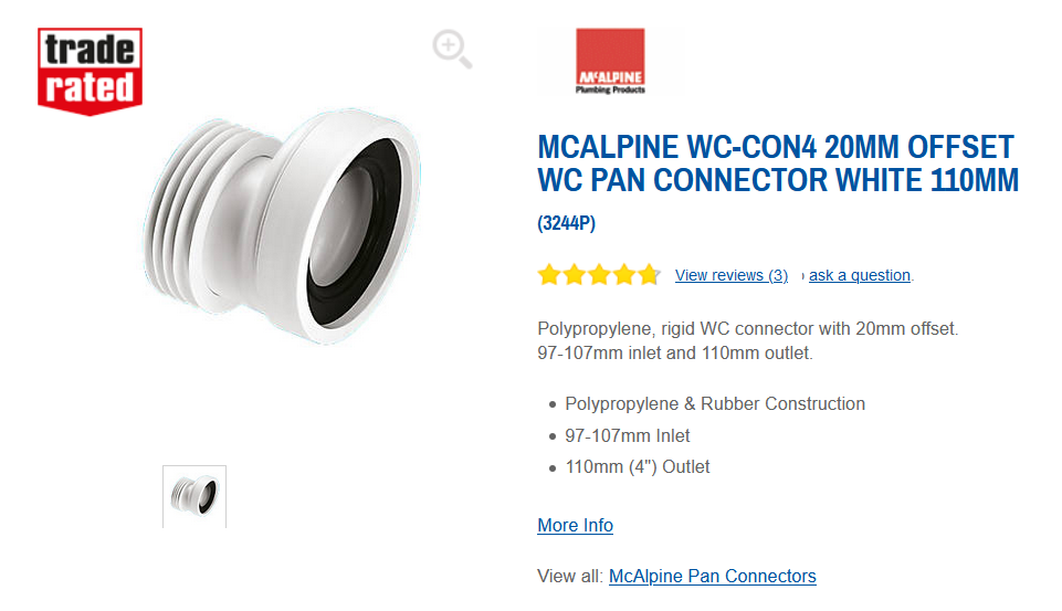

I'm trying to replace my old bottom outlet toilet but struggling to find one that will fit. The dimension that matters is the "roughing in " distance which is the back wall to the centre of the spigot outlet on the wc. I got one off ebay that looked perfect but when it arrived it was 200mm and not the 250 I need. I'm starting to think this will be difficult to find ... does anyone know who would stock something like this (close coupled not a thunderer high level jobby?)Thanks
Here's an option, this pan is 230mm wall to centre of outlet and with a 20mm offset pan connector will give you the 250mm you need, you may have to chip out a small bit of the floor for the connector to sit down but it will be hidden with the pan.
https://www.idealbathrooms.com/products/toilets/toilet-pan/e11145wh-5648#
