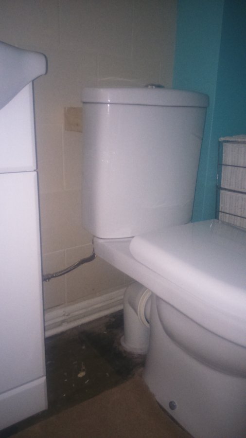

I'm getting annoyed now. I have a customer that needs a BO toilet @ 225mm centre from the wall. I have about 15mm to play with too.
Now as yo probably know these are few and far between and have suggested 6 so far and they don't like them. Anybody have any suggestions to BO toilets?
So far I have suggested Twyford E100/Twyford Alcona/Milano Babel/a Burlington and an Ideal that I found out to be export only.
Any suggestions greatly received.
Cheers Jon.
why not just get a standard pan and fit suitable pan connector.

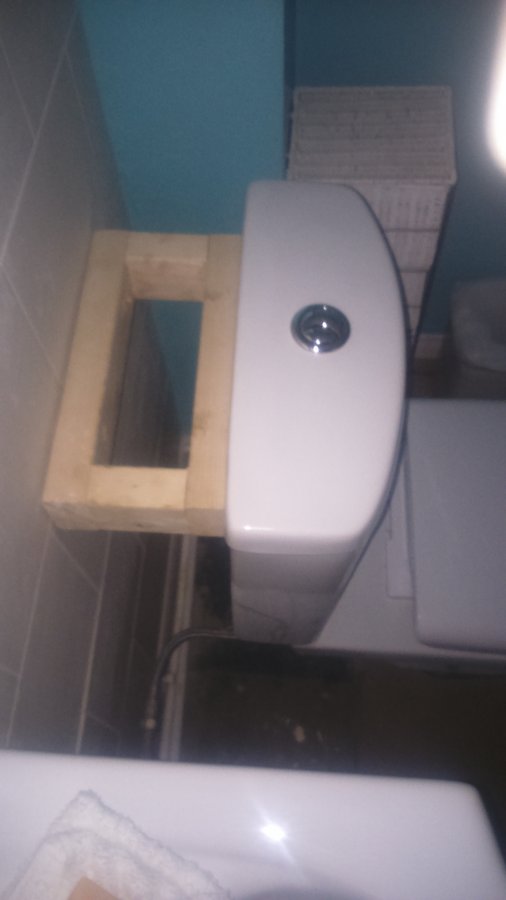

Because the customer wants the cistern back to the wall. A standard pan with pan connector throws the cistern about 190mm from the wall and they didn't want boxing in. I have given them all the options I can find now so the next step is to talk them into either digging up concrete floor and re positioning the drain or a custom boxing that will suit the existing toilet.
They had a guy in who cocked a lot up and took them for £2k so I got called in to put it right. Toilet was left with the cistern swinging in the wind, a rad fitted with the TRV horizontal into the room, pump changed and still leaking, a K1 rad 300 x 1400 to heat a 28m2 living room, no sealant on anything and broken tiles and holes left in the walls from removing overflows.
This is the kind of quality I'm following! The wooden frame was something I put in as a temporary measure until they have decided what they want to do.

Twyford 3D allows for a distance of up to 245mm from the wall to the centre of the soil connection with a question-mark pan connector. Not cheap though, looking at the best part of £400 for the suite
Cheers @muggles
Hadn't seen that one but from what I've shown them they would hate that. Being fair it is an ugly bloody thing lol
There's very few options for them for BO toilets and the price isn't an issue but I just hate that they've been done for £2k for work that would've been about £1.5k tops done properly in the first place.
Jon
Out through the wall and underground to pick up the drain ?
