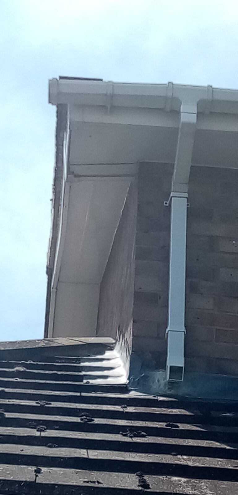

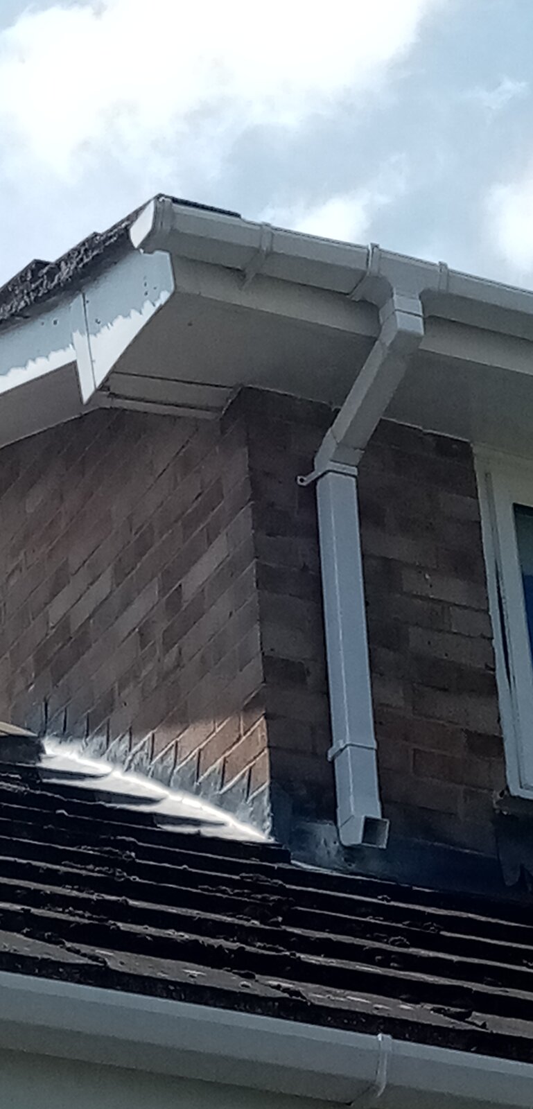

Does anyone have an opinion on this

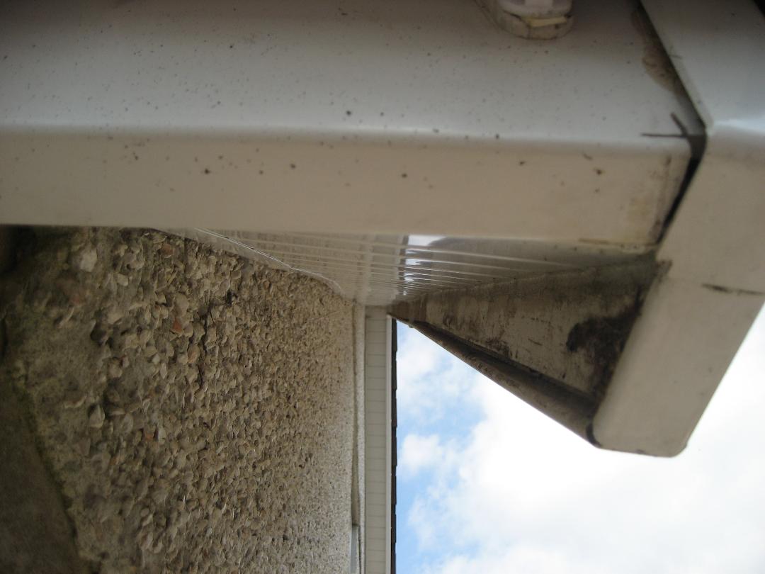

That looks very similar to what happened to mine, unfortunately the wooden framework/rafters underneath that part were rotten and had to be re-built
All of the exterior parts of it - facias/soffits etc have to come off, also enough tiles to get access, and then the wooden framework underneath (which usually looks like a "ladder" can be assessed and replaced where it`s needed.
I`m not a roofer so some of my terms may be wrong but I`m just telling you what I saw from my own roof being done. The wood on mine was absolutely knackered, it just crumbled in my fingers. Not a particularly cheap repair either so shop around
