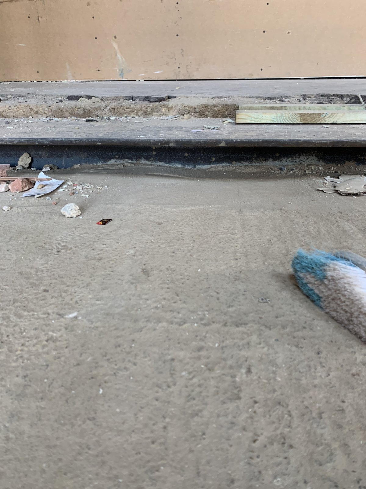

Seeking some advice. Had a box frame steel beam put in for a new extension.
A trench was dug for the bottom beam.
The top beam was lifted higher into the floorboards to create more head room.
The base beam has been filled with concrete.
There is no way 100mm of concrete can fill the top of the beam to create an encasement.
Also doesn’t appear to be any wire mesh.
Do I need to call building control to check ?
The structural engineer plans suggest the base beam should be encased with 100mm concrete with a wire mesh.
Any advice.
Thank you.
Call the se, explain what's been done, if it doesn't meet the spec and isn't acceptable then ask the builder to redo it properly

What kind of cover are you after? Just get the SE to write it down so that everyone is clear what is being accepted.

Structural engineer plans note
Provide305x305x97UC bottom beam to box frame, laid along existing rear wall, below ground floor level.
Bottom beam to be wrapped in D49 wrapping mesh & encased in 100mm concrete surround.
The ground beam is down to the existing foundations so it’s not supported on brickwork it’s on solid concrete,
If it is wrapped it in concrete it would be over the original floor level,
Building control have no concern about wrapping it in mesh as it has been mass concreted it in.

Did the builder put any mesh at all? It does look like they misunderstood the wrapped and encased bit thought it meant 100mm of concrete top to bottom rather then all around. I'm wondering if there is some mesh hidden in there somewhere.
Either way it certainly doesn't meet the spec so the builder and se need to input to work out what was done and what needs doing if anything next.

Beams within the ground tend to be required to have concrete encasement to protect against rusting, rather than for strength. But this is one for the person who specified it to answer.
Seriously though, I would be having words with the builder as to why it's not done exactly as specified. With building, lots of things can be "near enough" and still be acceptable, but the structural engineering design is not one of these.
