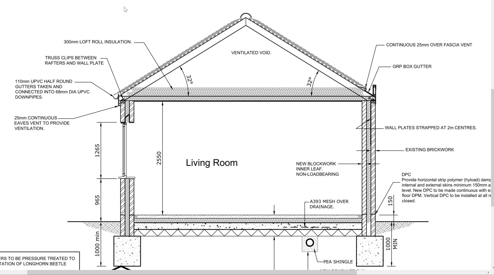

We are building the garage conversion and the back wall of the garage is actually the boundary wall so instead of a fence the neighbour sees a brick wall. It was decided then that there would be a box gutter running at the top of this wall so as not to hang out over the neighbour. However the builder has now found that we cannot have a normal cavity wall at the back and that the roof trusses will have to sit on the outside skin, and because of this we cannot have a box gutter anymore. I will ask the neighbour for permission to install a normal gutter but he will probably say no. Is there another way to solve this problem you can suggest?

I had a look at the plans and it clearly shows a GRP Box gutter and this is what we are going to do. Somehow the builder wanted to build a little parapet with bricks to hide it from view and this cannot be done if the trusses lean onto the outer skin.

Don't suppose you could post a section showing this box gutter to put everybody's minds at rest. I presume the inner skin of the wall has been built off the floor slab.

Precisely yes. It has not yet been built but will be next week. The slab is around 6 to 8 inches at that location. The planners however know about this and have designed the following:

Confusing -what is existing and what is new , inner leaf will be wall will be built of slab but drawing shows all walls built off substantial concrete foundations,no trusses shown,one wall hatched as 2 skins of brick ,other as brick and block, no rafter trays at roof /wall intersection , sharp internal corner on 'box' gutter instead of flat channel ?!
Could go on.
What's the vertical bit retaining the box gutter supposed to be? A cricket bat? How is the water supposed to pass each rafter? A kind of RMS Titanic sectional sinking scenario?
