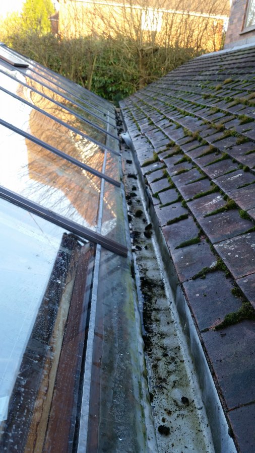

I have a box gutter between the single storey roof and conservatory.
It's aluminium and made up of 3 sections.

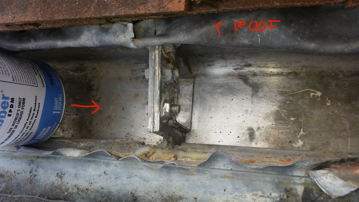

Since I moved in the gutter has been leaking where it joins, if you look at the picture you will see there is a bracket inside the gutter itself. - It looks like the bracket is how they have attached the two sections of the gutter together.
1.)
a)Is this normal
b.) Should it not be over lapped?
c.) Is there a resolution?

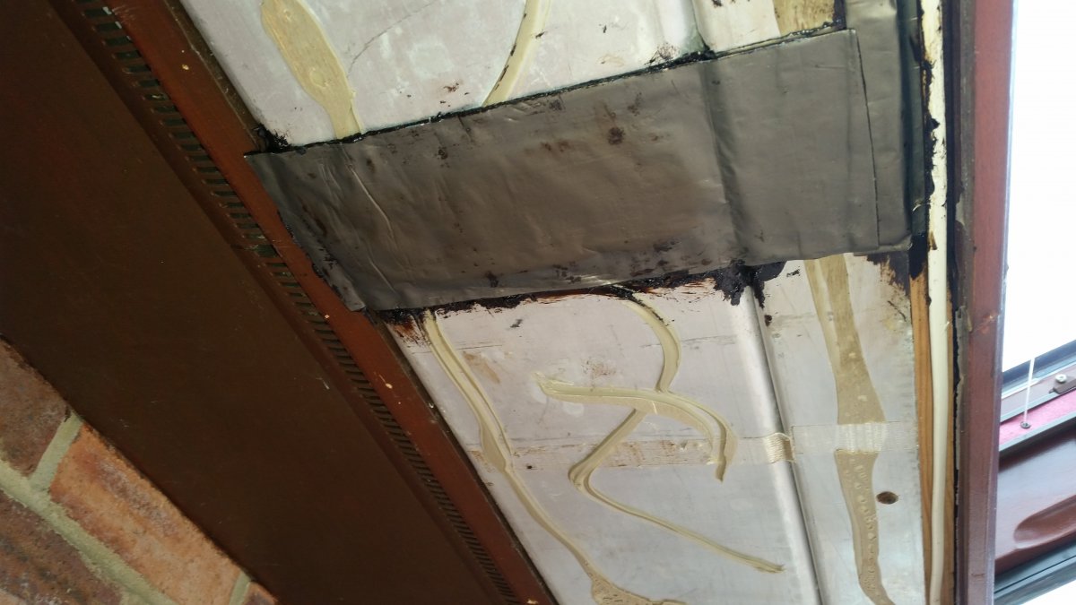

Beneath it looks like this - //www.diynot.com/diy/media/inside-conservatory.88472/full

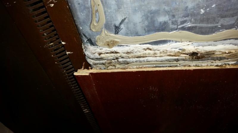

And it looks like they used something like sikaflex EBT inbetween the two gutters, to act as a kind of seal and to hold it together.
Anyway the water is obviously coming through a pinhole gap under that bracket and it then reached that sikaflex stuff, which is now 20 years old and then continues to drip down in to the conservatory. I get a few drips per day, unless there is particularly heavy rain.

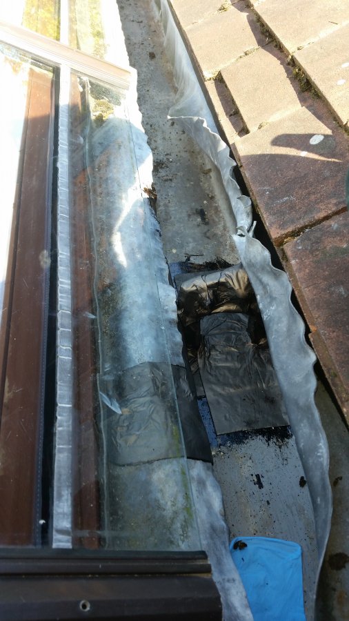

c.) Bitumen flashing, on one side I used generic cheap flashing, with no primer and it was not bone dry. This has held up for a year, but looks to be lifting after the cold weather. - I was going to redo it this year
d.)Bostik Flash band with Bostik Flashband primer licked everywhere and wrapped everything I could see. This was installed in the bone dry and looks to be holding up to the job like glue.

4.) In the meantime while I am waiting for the summer, I actually "fixed" the leak from the underside of the gutter, by cutting out a few cm's of that glue from the whole section (which is now not holding up) and pushing up bitumen mastic in between the hole, then flashing over the section. So this should hold until the sun comes out.

I'm not an expert but I'll put in my 2p's worth.
Those brackets are pretty bullet proof as they can't move so never leak.
Are you sure water isn't getting in at the back? There is a tear in the lead.
Conservatory guttering is dead level, without any falls. If it's all connected in one loop, just dam the hell out of that join with as much gunk as possible so the left water goes to the left and the right goes to the right, plus you can lead over the top of it to help even more.
MW Roofline, Thanks for your reply.
I am 1000% sure it's coming in via that bracket. I made the two slits in that flashing that you see.
It was like this (see raised bit of flashing):
I put the slit in so that the lead sits flush in the gutter and that bit in the middle sits on the bracket. When it first started leaking I was worried because that 10cm section of lead was sitting at a right angle,( was resting on top of the bracket) it was causing water to back up towards the roof, rather than in to the gutter. The incision now lets the whole length of flashing sit in the gutter.
After sealing all around that bracket the water stops coming in, so it has to be coming from there. This is what the "good" side bracket now looks like:
As you say the box gutter is level, so water is always sitting in there pooling. Problem is there is 3 sections, even if I was to raise the entrance + exit of the bracket with bitumen mastik , there will always be water in between the two brackets (one wanting to go left, one right).
I presume you will suggest the butyl tape over the primer +bitumen flashing?
If the Butyl tape really lasts over 10+ years from your experience, to be honest i'd be happy with spending an hour every 10 years :) - I was just wondering if there was a more permanent fix.
