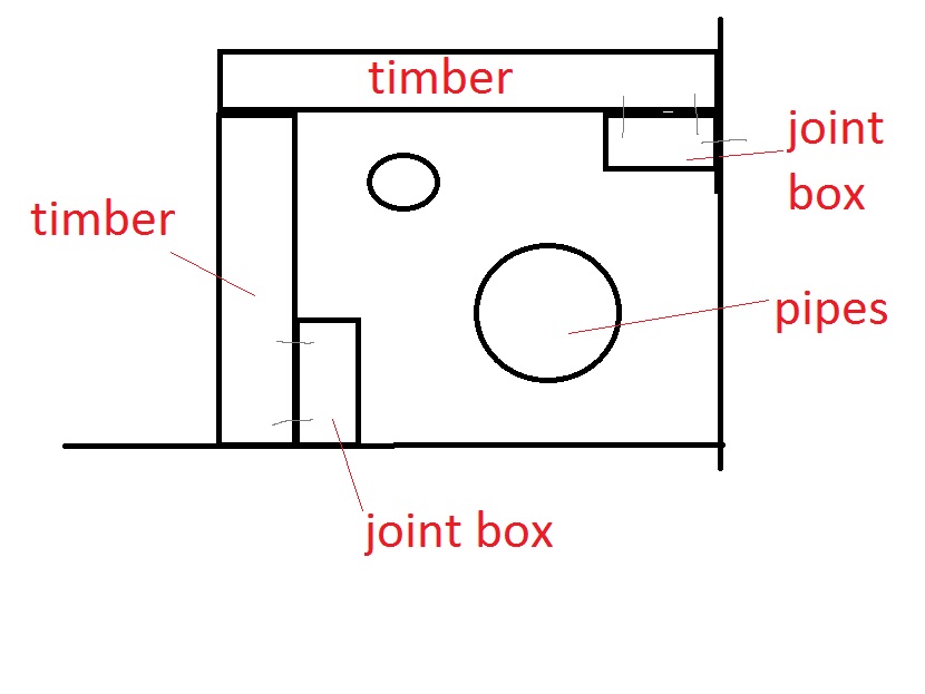

I'm looking for some way to box in some pipes in my kitchen.
Would like to use upvc if possible.
Any ideas as I can't find an L shape piece big enough.
Packs of UPVC pipe coverings from Screwfix.
Looks like you may need two sections stuck side by side to cover both pipes, or alternatively you could get a section of UPVC Fascia boarding and cut it down width ways.
67679_P
67679
Here :
Use those flat pack assemble joint boxes you can get in screwfix :
http://www.screwfix.com/p/white-assembly-joint-x-10-pack/25399

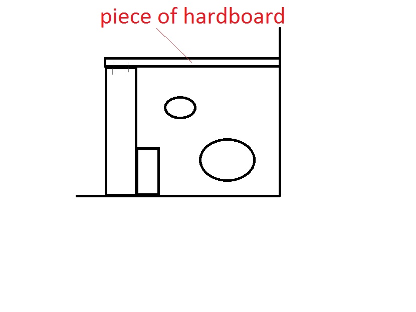

Better still do this :
Nail the hardboard with panel pins so that it can be easily taken down for access because you have some fittings there by the looks of it.
Everything can then be painted how you like.
Or if you can find a large enough piece of pvcu, it's up to you. Good luck
