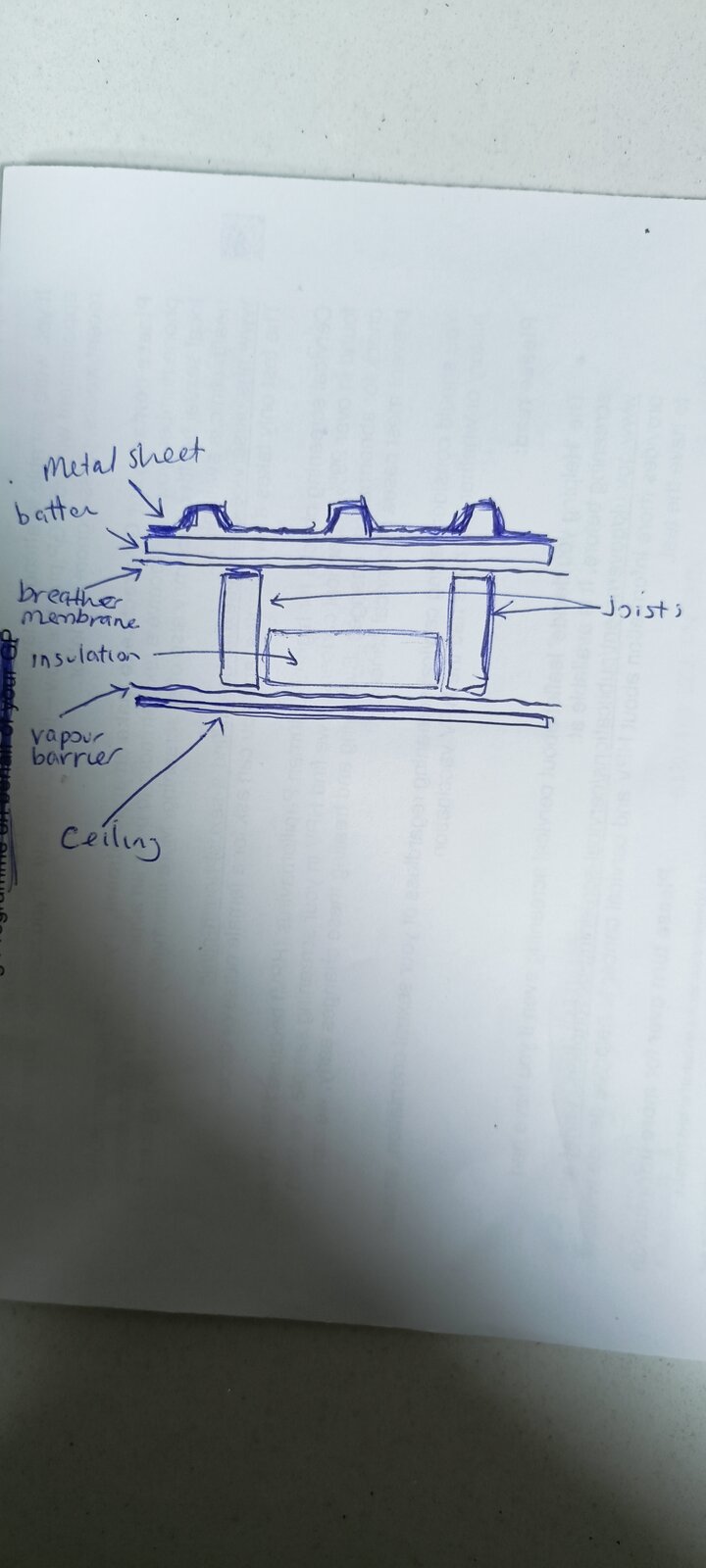

Hi all,
Constructed the timber roof structure for my garage and will soon slap the finish on top. Decided to go for some box profile metal sheets after considering few different options, but this seems to be a cheaper, long lasting option.
I am aware condensation can be a pain with these if not prepped correctly, which is why I wanted to run my thoughts through the forum...
This is how I plan to lay them, from top to bottom:
Box sheets
Fixing Battens
Breather membrane
Joists
Gap for air circulation
Insulation between joists
Vapour barrier (dpm or something sort of polythene sheet)
Ceiling (plasterboard or timber sheeting)
There is no boarding to save £400-500 on OSB.
So my understanding is that I have to stop the warm air inside the garage reaching the metal sheet to cause condensation. So the ceiling and vapour barrier should help with that. Insulation does what it's designed to do. Breather membrane to allow any moisture to escape, and a gap allowed for air circulation.
Let me know thoughts please.
