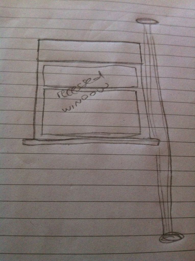

How much is between the pipework and the edge of the window?
You could cut the timber sheeting so that it is flush with the edge of the plaster work around the window and just have your timber batten above and below the window.
Does that make sense?
Andy
Andy

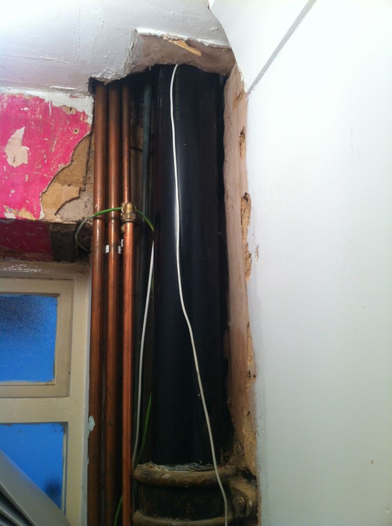

Theres not much gap at all, i think i would have to fit to the inside of the window or batten above and below it? Im taking the window out and replacing with glass blocks and also getting rid of the window sill and replacing with a flush one
Heres a photo anyway http://i1244.photobucket.com/albums/gg580/Thyjones/942009c8.jpg
If your changing the window then it would be best to change the window first and see what you have to play with. I would move the 22mm pipe on the edge out of the way.
