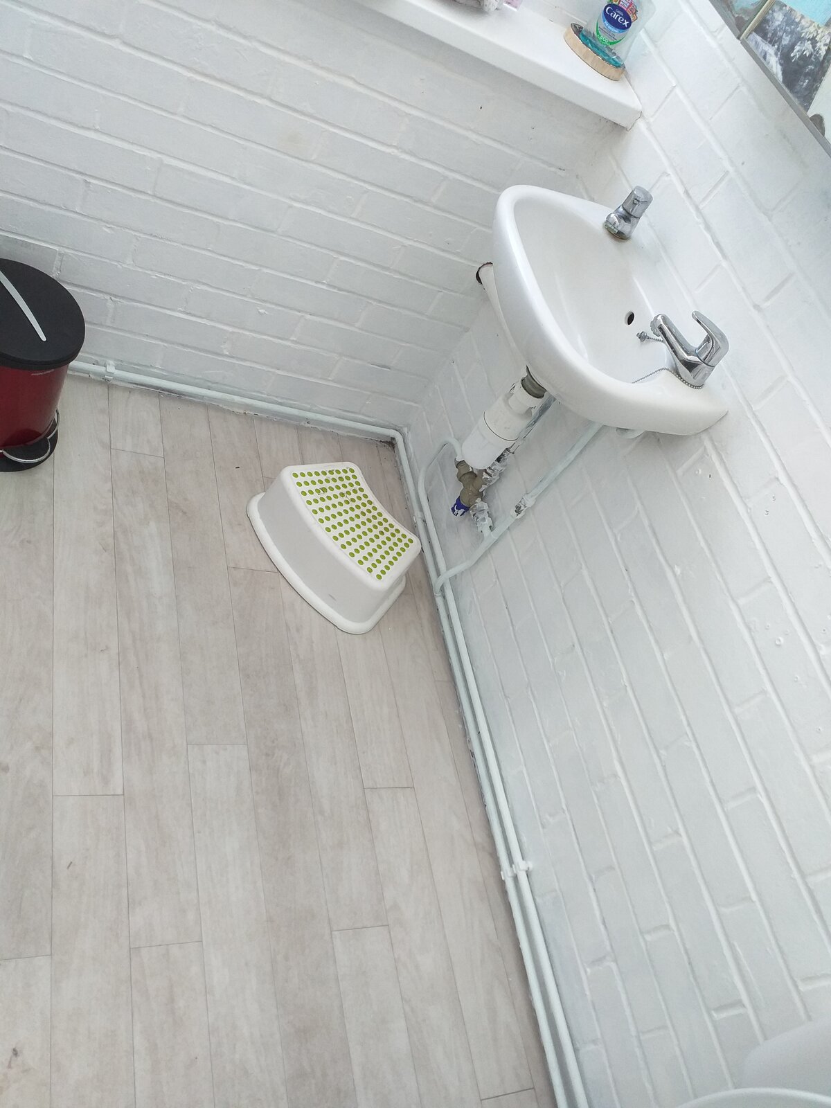

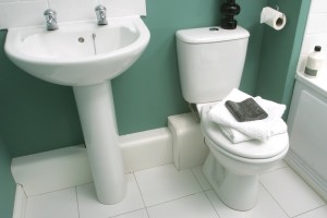

Need to box these pipes in and possibly the pipes running up under the sink. Shall I use baton then MDF or ply?
Under sink the same? Build a frame with baton then build around?
I would baton and then use solid wood skirting over the pipes at low level, painted on the back before fitting. I wouldn't put MDF in contact with the floor.

So baton into wall and piece of baton on inside of corner using skirting which is square at the top and no shapes on it.
Why painted? To waterproof?
The original Talon stuff can be clupped cdirectly to the pipes if you havevthe correctvtype of pipe clips. Odd stuff you will need to resort to 6mm plywood and 2 x 1 softwood battening
Yes. If the skirting is in contact with the floor and the floor is going to get wet (which it will in a toilet with a single skin brick wall), you want to waterproof the skirting.

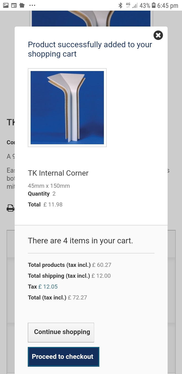

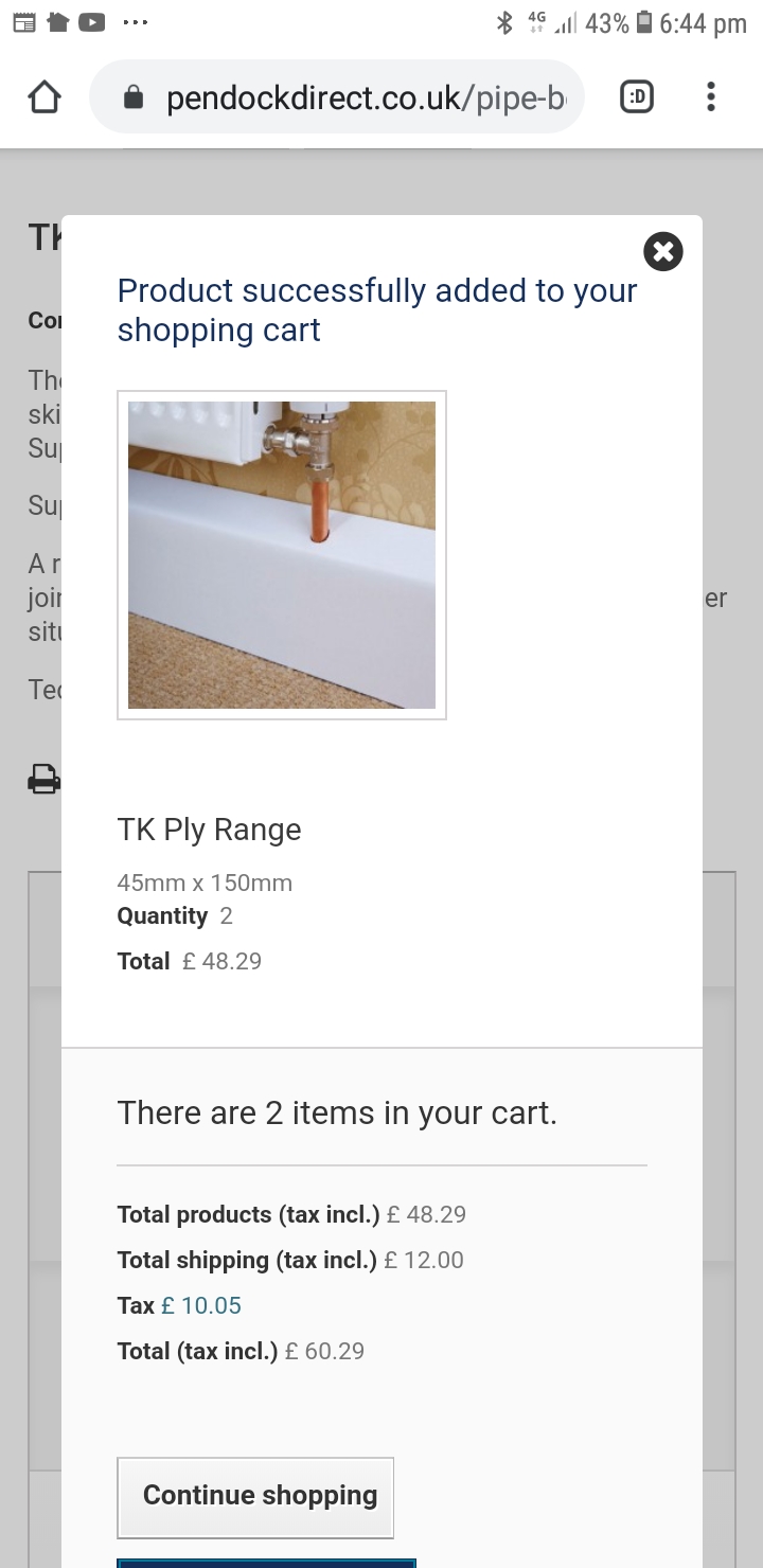

Looks lovely. Before I order 45mm x 150mm would clear the piping in the picture surely?

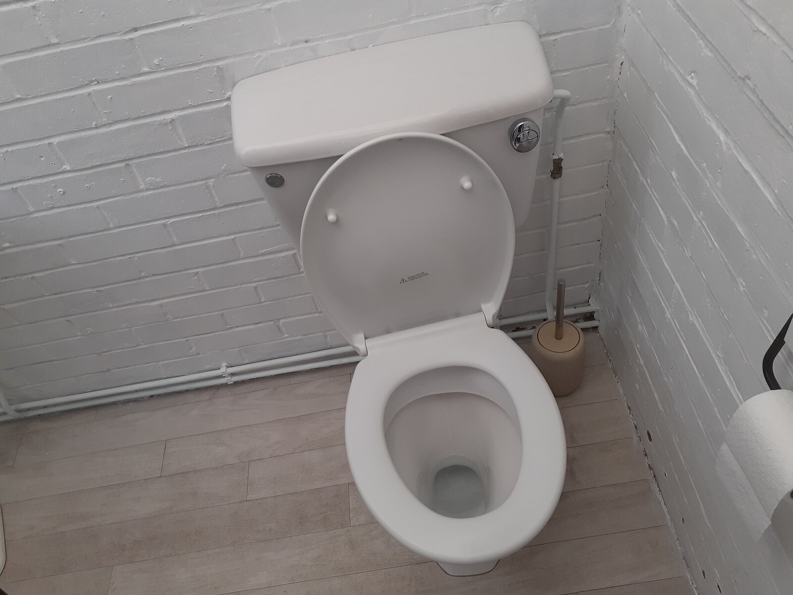

There's also a toilet not in the picture as well. Can you get anything which is bigger for this and the pipes under sink ?
I would be doing away with that cold tap, unless there is a need for cold for drinking/toothbrushing. You can set that thermostatic mixer to a comfortably warm temperature for hand washing.
Want to check if pipework will fit? Make up a test template the same approximate size as the Pendock (hardboard would do).
There is no reason why you can't use two pieces of Pendock and join them together to make a single, larger u-section by using something like a 12mm plywood binder piece up the inside, behind the join. And the larger MXF fire boxing goes up to 150 x 300mm, if needs be. Being plywood based it is also possible to trim down a Pendock section by 5 or 10mm by using a circular saw with a fine tooth blade (although a table saw would be better) should a tighter fit be needed
I precut with a stanley to reduce breakout on trimming, which seemed to work pretty well. I actually found that the Pendock pieces to box in pipework under a boiler were a better size for the bathroom pipework, so I used them instead.
The pipes are wider under toilet as they jutt out 60mm. I guess just get a deep enough boxing one for that area and keep same depth round the rest of the pipes the rest of the pipes are 35mm out from the wall.
