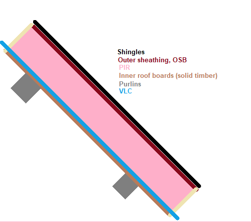

In my other thread (https://www.diynot.com/diy/threads/does-this-roof-need-a-dpm-or-not.533146/) I talked about an 'ice cream sandwich' design for an insulated, felt shingled roof on our cabin, which I believe is not especially common in the UK but reasonably well known:
The extra frame adds quite a lot of material and labour costs and I was interested to read this alternative solution on the blog of a guy who constructs cabins (scroll down past the section on floors to Insulating the Roof of your log cabin)
https://www.tuin.co.uk/blog/insulating-a-log-cabin-floor-and-roof/
In short for thinner insulation (up to 50mm PIR) he endorses nailing shingles through the PIR into the roof boards with longer clout nails, relying on the compression strength of the PIR. There are a bunch of photos and better description in the link.
Our SBEM guy has currently got our roof insulation down to 75mm and is investigating if we can get it to 50 while adding extra elsewhere because the recommendation is you do not follow this design beyond 50mm. My builder agrees with that assessment.
I'm happy to trust my builder if this is practical (though thoughts welcome) But my main question is whether there any specific BR this breaches? For instance they don't recommend a VLC here - I assume because the lack of external wooden sheath allows warm air to escape rather than get trapped(?) and I am not sure if BR requires one, or makes other very specific requirements here. Or is this within the scope of me deciding how to do things (the SE had no issue but then that doesn't mean much probably).

Cant the shingles be nailed directly to 18mm OSB board or structural ply?
As in just put a layer of OSB on top of the PIR all the way across, screwed through the OSB into the sub-roof/rafters? Someone (maybe you?) mentioned that in the other thread - not to build a frame in the insulation layer but just lay a board on top relying on the strength of the PIR.
the normal way to fit insulation in a flat roof is to cover the roof fully, no gaps, then lay on the 18mm OSB board and screw through with long screws -180mm are needed for 120mm insulation.
you dont need a frame within the insulation layer -it would only be detrimental to thermal qualities
That's interesting. Now my roof isn't flat but it is only 15 degree pitch. This would certainly make things much easier!
