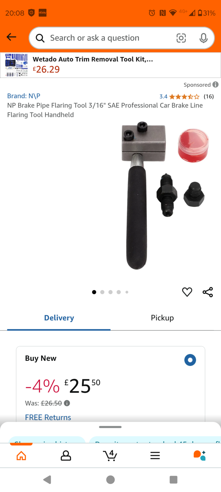

Is there a good general purpose kit for all cars ? .....albeit we have mainly VW and Ford in our family fleet.
Sadly none of the motor factors now make pipes now so I need to consider stocking up.

The cheap sets will only flare copper. So no use for flaring on the car to join existing pipes. Ok if you are renewing whole lengths of pipes..

I've always found these to be not up to par, I don't have one and, I wouldn't recommend them.

The first thing to do is find out what kind of flares your cars have. The two common ones are DIN and SAE. The cheaper tools seem to do SAE. Most European cars use DIN.
