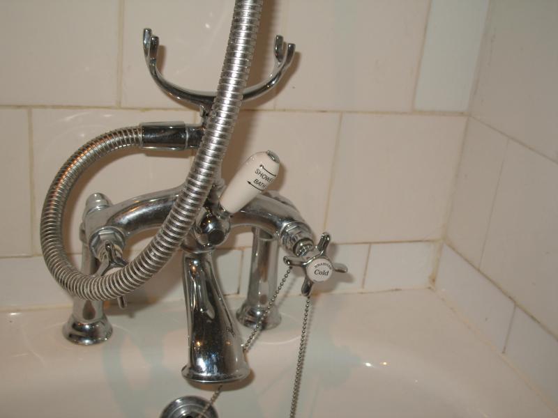

I've got a Bramham bath shower mixer tap - the classic type like the old cradle telephones. It has a lever between the taps which is swung one side or the other to change from bath to shower - this has become incredibly difficult to move. I'm not familiar with the internal mechanism - is this likely to be scale or a defective washer or some other simple cause??. More to the point, is it likely to be easily fixable?!
Any help/advice appreciated. :)
PS I did see an exploded diagram of a similar mixer and it did look more complicated than I imagined!
Could just be an O-ring slipped out of position.
Could be natural wear and tear on the mechanism.
Different taps have different arrangements.
Take it apart carefully and have a tub of silicone lubricant and an assortment of O-rings on hand for reassembly.
These things are fairly easy to take apart, so undo the nut that allows the change over lever to be pulled off.
Next undo the boss that holds the change over spindle into the tap body - with this out you'll see a brass disc with an eccentric peg that locates into the change over mechanism. Often enough these pegs break off, in which case you can't change from bath to shower.
If yours is ok the problem will be verdigris between the spindle and the boss so you should gently be able to pull the spindle through, twisting as you go. As said above, proper lube helps a lot - with luck the 'o' rings (2 if I remember) will survive.
John :)

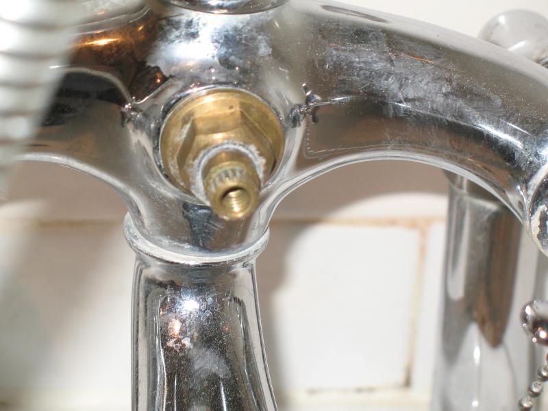

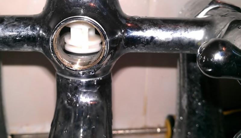

A guy you helped before had a Screwfix clone of my tap which I found under "Mixer Turn Operation Not Working"- I assume they're similar internally? He took some great photos as he dismantled it. One of the photos shows the disc and peg attached to the boss unit. I assumed the peg engaged with the internal nylon fitting which is why I thought there might be a problem when the boss unit was unscrewed (and the peg turned?).
Regards.
Certainly I don't want to get myself into deep water here (pun intended :p )
The obvious thing to do would be to heave on that brass nut, and undo the insert.
However.....I'm reasonably sure that there is a brass peg on the back of that thing, that engages into whats called a shuttle that lifts within the tap body. When the shuttle is down, the shower works - when it is up the bath filler works. Therefore, we rely on that peg disengaging from the shuttle as the insert is turned but we can't be at all sure this would happen.
If the tap was mine, I'd want to hold the central spindle still whilst the nut is undone......this will leave the pin in place in the shuttle.
Presumably there is a circlip holding the central spindle in place which can be prised off? The central spindle could then be held with pliers as the nut is undone (WD40 would help here).
Worst scenario - the shower / bath filler wouldn't operate as it should, but at least there wont be a flood as the main hot and cold taps control that bit.
At this point, how I wish that others would chip in :p
John :)

Photos here are what the other guy submitted - it seems he removed it with the peg and circlip intact. I don't apear to have a circlip but I suppose I could still hold the spindle regardless.
Never did find out what happened with his mixer although it was only a few months old and still under guarantee.
