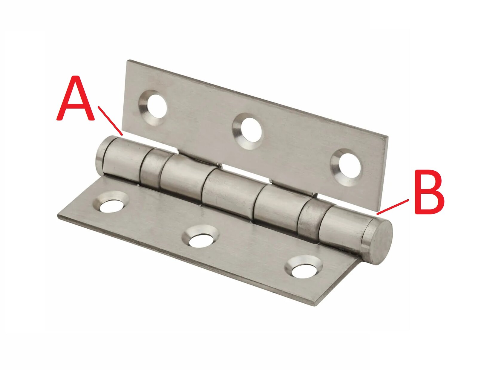

Hi,
I've just bought 8 pairs of 3" ball bearing hinges. These ones to be precise,
https://www.ironmongerydirect.co.uk...-x-50-x-2mm-satin-stainless-steel-pair-417504
I bought them because they get loads of excellent reviews, however every single one of them has a bit of play in it. Is this normal for ball bearing hinges or have I bought a load of duds?
Here is a picture of where the play can be seen. I can get the gaps at points A and B to open and close. With the hinge opened, the gaps at A and B are about 1mm, but if I apply a bit of up and down wiggle I can get the gaps to close to about 0.5mm and open to about 1.5mm.
Thanks in advance.
if you hold the leaves dead parallel, how much movement do you have
With the hinge leaves parallel it's exactly the same. Untouched the gaps at points A and B are both about 1mm but can be opened and closed to about 0.5mm or widended to 1.5mm. In fact the play is there from the hinge being fully closed to fully open and every angle in between.
There's actually less play in most of the 60 year old butt style hinges I'm replacing.
axb are irrelevant as the hinge only pivots thought the vertical axis
to move the hinge in way you describe would mean possibly 20-40mm sideways at the other hinge and as that wont happen its not important
I think I sort of understand what your saying, but wouldn't up/down play mean that your doors could eventually start to sag and your latches miss their keep hole?
I've just got back from one of the high street diy sheds after buying a pair of Eclipse (model number 14852) ball bearing hinges to compare them with. They also both have the same play in them. So it must be a feature of ball bearing hinges. However it's about a quarter of the amount of the play I'm seeing in the ironmongery direct hinges.
i cant really answer the question but would expect at least a small bit off play [less than say 0.5mm] to stop it binding up in use
Not really. The stuff we fit (Arrone, etc) has negligeable or no play at all. In fact they tend to be stiff until they bed in a bit. If they start sloppy, they'll only get worse with use IMHO

Have any of you guys ever examined any ball bearing hinges that have been used for a few years on doors that are working perfectly normally? It would be interesting to know it they had up/down play in them and how much. This could all be a non-issue.
Yes, and I have replaced sloppy ball bearing hinges in doors in commercial establishments which have had 5 to 10 years usage (think restaurant front doors, office WC doors, hospital doors, etc where major use and abuse occurs). Wear and tear depends on usage, but ball bearing or washered hinges just shouldn't start out sloppy when new.
