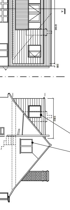

This is from the architects drawings. Tiles clearly shown on the dormer cheeks/sloping roof and clearly not shown on the gable end.
The project manager showed us other plans for other jobs where the architect clearly shows tiles on the gable end when tiles are planned.
7. I take it that the gable in the posted pic is the gable in question?
No annotation (writing) is visible - gable is a blank?
Where is a rendered gable shown?
- that is how the architect shows render. It was done after a specific request via email to correctly how the gable end rendered. The same as the existing wall. The is no annotation.

7. The architect is wrong. The conventional symbol for render is a multitude of small dots similar to the concrete symbol.

The company has now decided that they will render the gable end. They wont be blocking/bricking it beforehand so the not so good option of rendering on a timber frame will happen BUT they have now agreed to give us the 10 year guarantee as per the rest of the build.
I'm happy enough with this solution and accept that in time we'll almost certainly have to do some repairs - but at least the first 10 years are covered.
