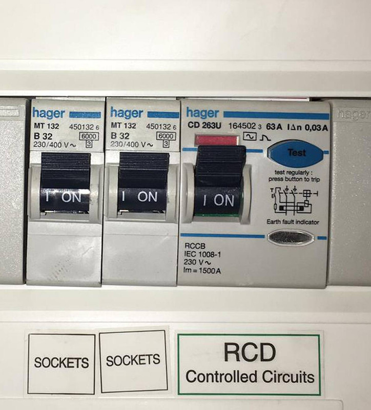

Last night my son lost power in his home due to a circuit breaker tripping;...he had his oven, hob, CH, and TV running the time. He also had his pop-up toaster in operation;...he thinks (but not certain) it tripped when the toaster popped-up/switched off.
Lighting was unaffected.
After re-setting the breaker no further occurrences.
Is this indicative of a an issue with the toaster?...breaker?...or something else?
The house was built in 2001 and I assume the consumer unit is original.
As ever, all advice gratefully received.

Post a photo of the consumer unit with the lid open so we can read the labels
What letters and numbers are on the device that tripped?

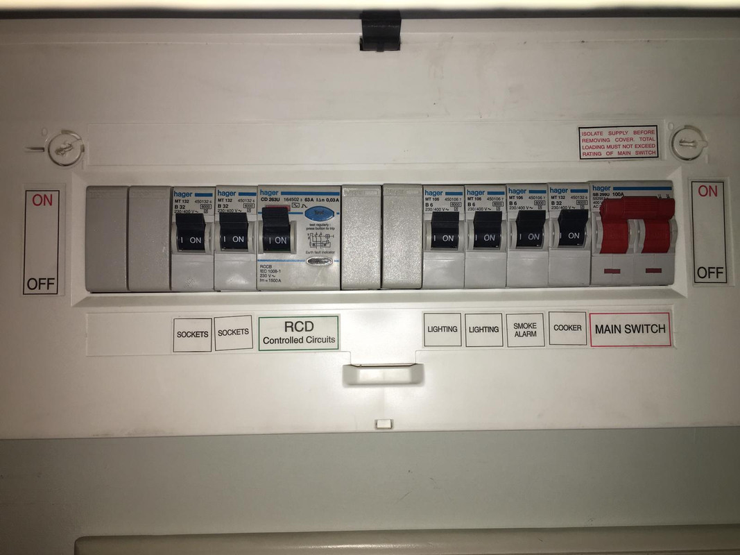

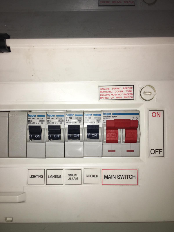

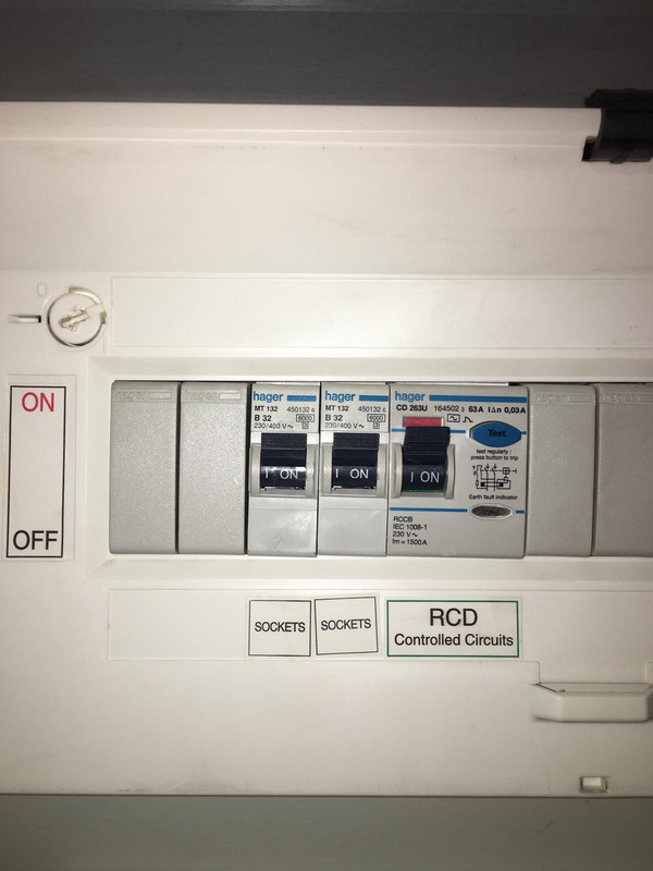

Son finished work at 2pm today which was handy;...got clearer info now.
See photos;.... it was the ‘RCD Controlled Circuits’ that tripped;...the oven/hob were NOT switched on so duff info in post #1...sorry for that.
Microwave Oven was on/ kitchen extractor on/fridge on/ freezer on/ CH on/TV-Sky box etc on/Broadband router on/pop up toaster on/ 2 x table lamps on/ Washer off/dishwasher off. Nothing else that we can think of on the ‘sockets’ side of things.
As I said in my thread starter he thinks (but not certain) it tripped when the toaster popped-up/switched off, but after re-setting and using toaster again (and all the other items) no further occurrences.

if the RCD tripped, you have an earth leakage fault, not an overload.
Most often these happen on watery appliances, such as kettles, boilers, immersion heaters, washing machines, tea urns, fishtanks, fountains, outdoor sockets and outdoor lighting or sheds (especially during and after rain). They do not have to be switched on at the time, but they do need to be plugged in or, for fixed appliances such as boilers, the wall switch needs to be on.
Start by looking for any trace of water leakage. If it happens again, UNPLUG all appliances.
It can also be rodent or canine damage to wiring.
if the RCD tripped, you have an earth leakage fault, not an overload. ... Most often these happen on watery appliances, such as kettles, boilers, immersion heaters, washing machines, tea urns, fishtanks, fountains, outdoor sockets and outdoor lighting or sheds (especially during and after rain) ....
Whilst it is certainly true that water-related issues are commonly the cause of RCD trips, so can be crumbs in toasters - so, given what the OP reported, that would be the first place I'd look. If it were the problem, it may just need 'de-crumbing'!

Many thanks for that;...a lot of potential culprits then.:eek:
