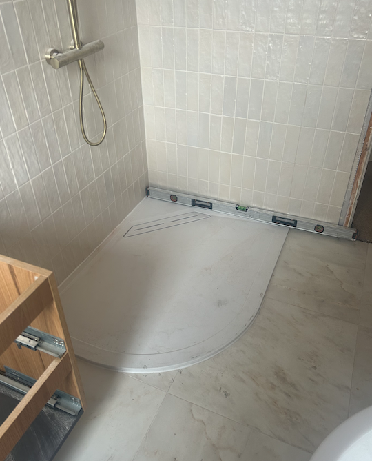

I posted here the other day: https://www.diynot.com/diy/threads/shower-tray-not-level-start-again.642940/#post-5937307

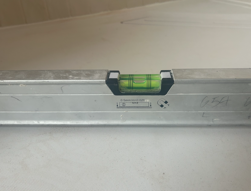

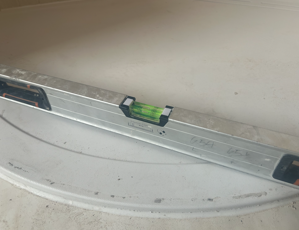

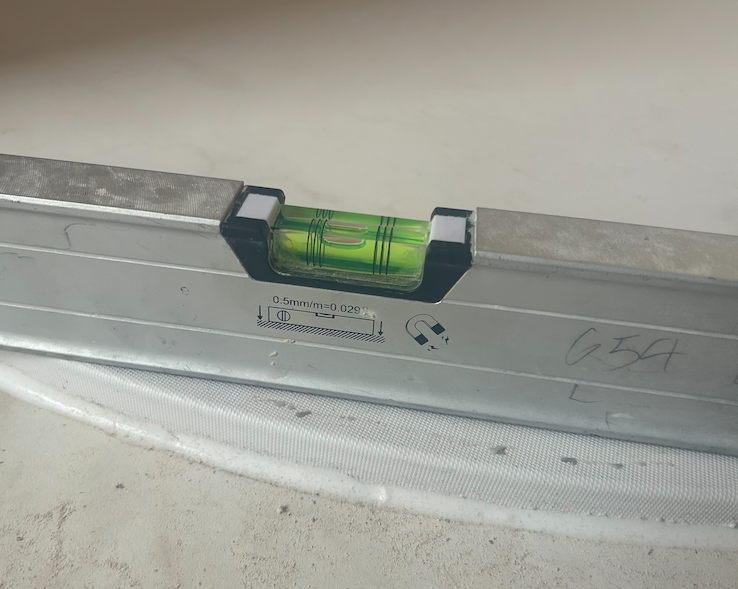

At the time, I believed my fitter had installed my shower tray badly which meant the enclosure could not be properly installed but on closer inspection, I think the tray itself is warped.
tray.pngbottom-left-2.pngbottom-left.pngright-side.pngtop-left-to-bottom-right.pngtop-right-to-bottom-left-2.pngtop-right-to-bottom-left.pngtop-side.png

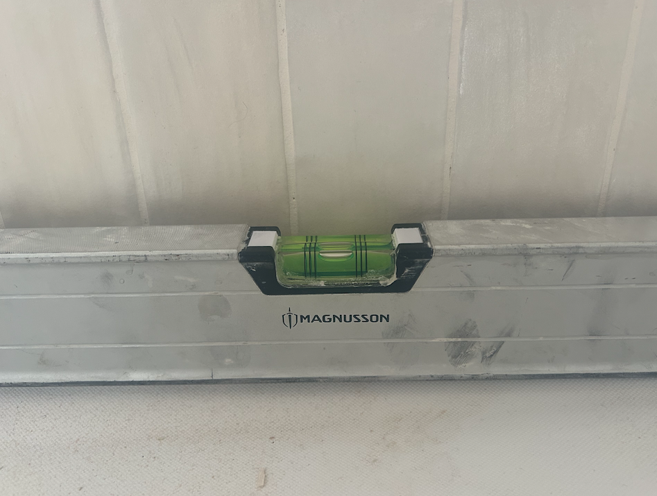

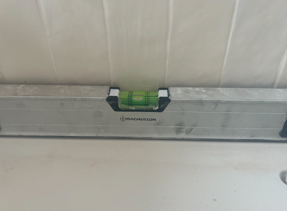

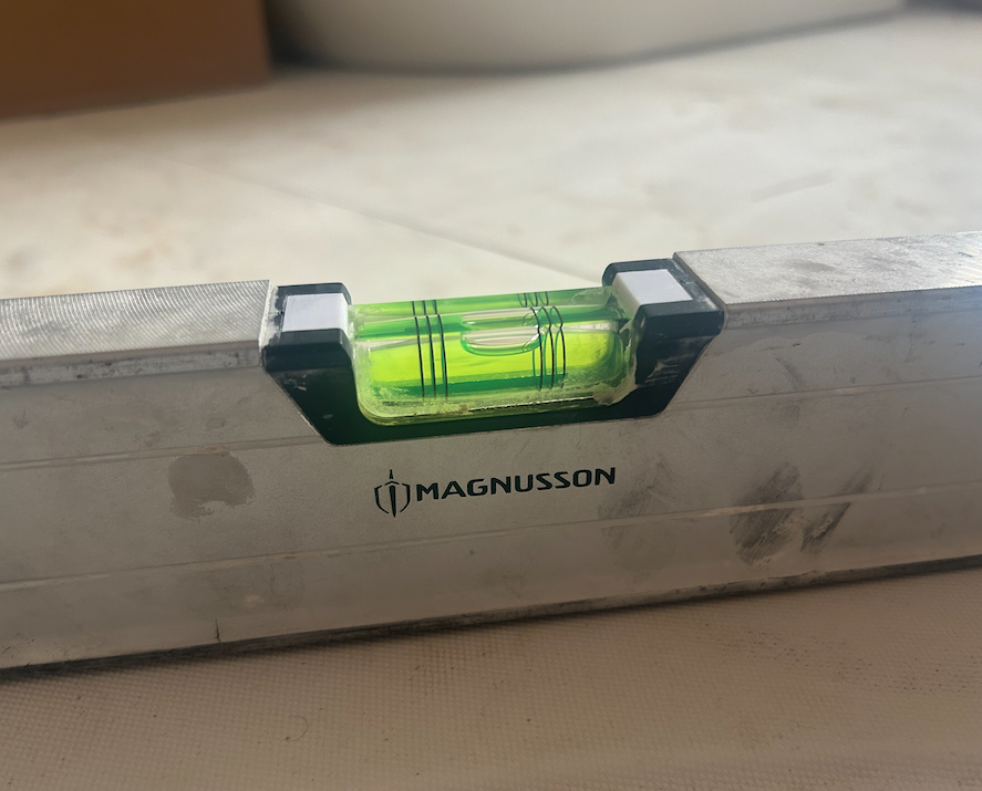

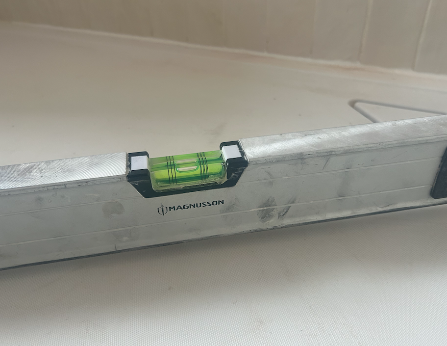

Effectively, the tray is to my eye level along its straight sides (slight deviation from level along the top edge but it's only a few mm out of alignment here) and its two diagonals but not the the spirit level is placed along the curved side. See image names on the thumbnails.
I reported the issue to Kudos so I'm hoping they agree. If they do, they'll refund the £270 I paid for this tray and I can purchase another. In terms of removing it, will a hammer and masonry chisel do a decent job of breaking this up without wrecking everything else? I believe it's cement beneath the shower tray surface..
Wall tiles will be fairly easy to replace and we have loads spare but I want to preserve the floor and underfloor heating.

Spoke to the fitter. The tray sits on a bed of tile adhesive, which sits on a cement board, which sits on the floor boards. The surrounding tiles sit on a screed that was poured AFTER the tray was installed.
Trouble is, once you yourself start the process, you sort of take ownership of the overall problem, which lets the fitter off the hook. The tray should really have been checked properly prior to installation or even better, on delivery.
Sorry if I wasn't clear. The fitter is happy to remove and replace. I won't be doing the work. In fairness to him, I supplied the tray and neither of us thought to check the level on that curve which was evidently a bit of an oversight.
The existing (hinged door) enclosure will look like a total bodge if it goes in so I was considering a sliding door that might better hide the issue but there's no guarantees that we'll even be able to install it so I think it's better we just bit the bullet and replace the tray (inspecting it more thoroughly when it arrives)

That's correct, in a nutshell the enclosure exposed the 'ramp' effect on the curved edge.
Have the walls/tiles been checked too? Are they square/vertical?
Yes, the wall tiles are rustic so they themselves aren't totally level but multiple readings in multiple locations on the floor and walls showed the bubble of multiple spirit levels to be level within the markings on the device.

We're going to replace the tray entirely on the assumption that it is actually warped and breaking it up should minimise damage to the wall/floor tiles.

I will be honest though, if the tray is out of level along the curved edge and that is shown in the pic bottom left , then I would suggest by the level's bubble that it isn't really that much out that the adjustment in the enclosure frame couldn't take up TBH.

New tray was measured to be level, old tray was drilled and smashed up with minimal damage to the tiles, floor or underfloor heating which came close to the edge of the tray.
The new tray went in but 2x tiles were badly chipped in the process, these were subsequently replaced and after grouting everything looked great.
The new enclosure has been reinstalled without issue.
