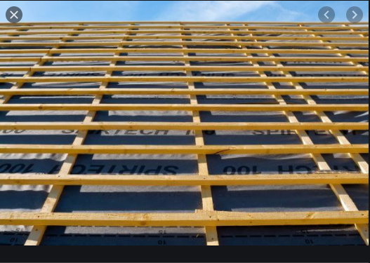

can anyone please advise me if this the correct way or whether this will cause problems later.
i am making a pithed roof and have got to the part where i need to lay the breathable membrane, only thing is i have already fixed the roof battens and now want to lay the membrane over the top of battens and then fixed tiles on top.
they are standard vangaurd 83 interlocking roof tiles that will sit ontop of the membrane once its laid along battens.
i know now the membrane should go under the battens but ive fixed battens now. so can i carry on the fix tiles now or does all battens need to be ripped up.

OP, I am an inexperienced DIYer and I thought the description sounded bad then when I saw Woodys gif I thought oh it isn’t some fancy new method then

That link is apparently describing a counter-battened roof. Yours is not.
This is counter-battening, and the membrane could be fitted above or below the counter-battens (bottom ones), but not above the battens (top ones)
A counter batten is different to the battens. It runs with the rafters, not across them. The membrane need some slack to fall into the gap between the rafters to allow any moisture to run down to the bottom and away. The way yours is done won't allow this.

It looks like you are building a conventional cold roof with an air gap directly below the tiles.
With such a construction detail the breathable membrane is unsupported - and any rain water getting under the tiles will pool on the membrane and can't escape.
Same issue with condensation.
I'm sorry but your best bet is to remove the battens.
As far as I know breathable membrane never s goes over tile battens, it may however go over counterbattens which run in line with rafters.
Edit: Woody posted whilst I was typing - see pic
