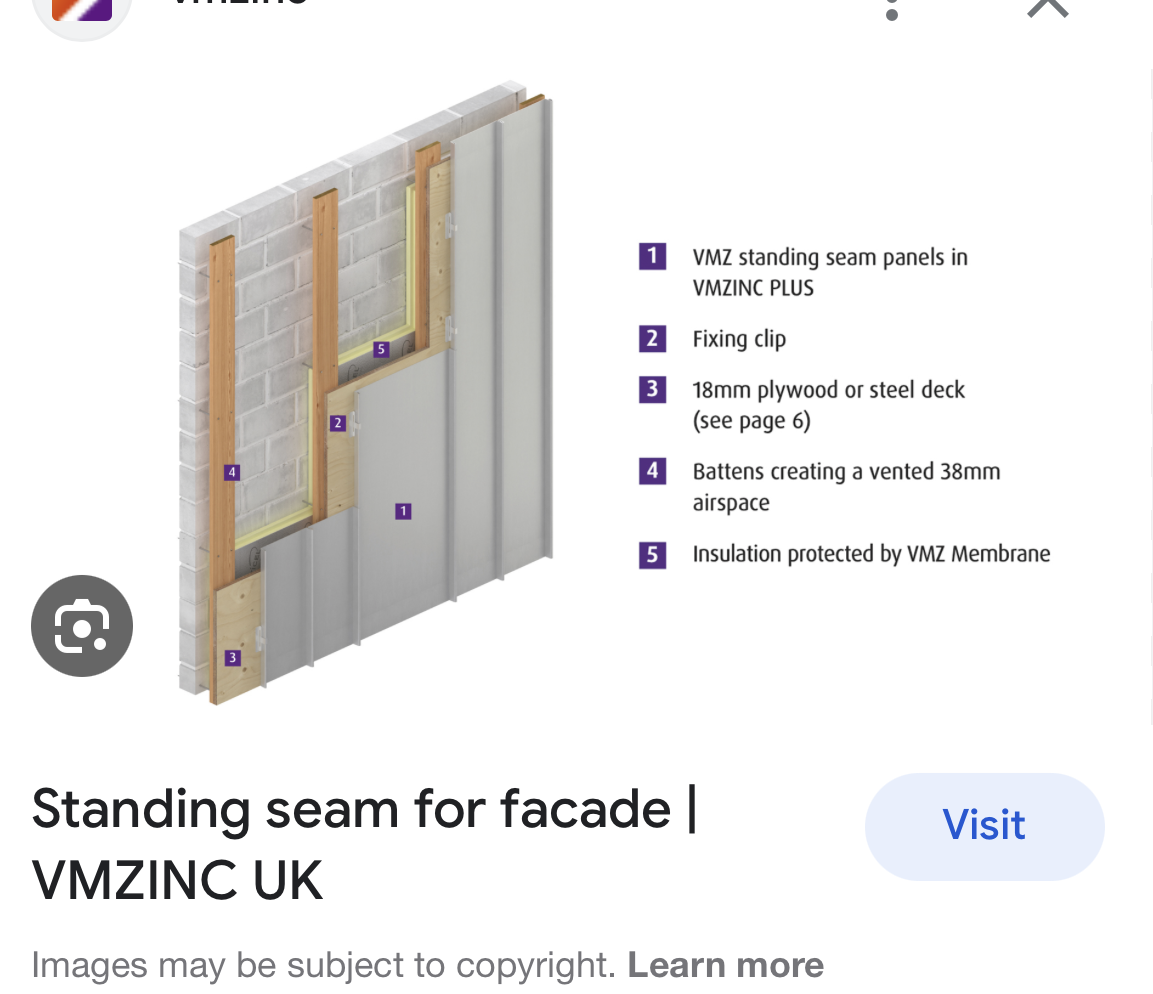

If you have blockwork wall with cladding like below.
Why do you not need a waterproof membrane in front of the blockwork?
Quick question why are breathable membrane pointless to fix to blockwork ?
Doesn't the foil on the insulation provide a vapour barrier? if it's taped up.
The breathable membrane is on the face of the insulation, so will not allow moisture or rainwater to penetrate (from outside into the insulation (or into the blockwork)) but will allow vapour to pass from the inside out.
Why do you not need breathable membrane for blockwork when it is porous?

Wherever there is a clear cavity (ie in a traditional block + insulation + cavity + brick/block wall construction) you do not need a membrane because any rainwater getting through the outer skin will trickle down the inner face of the outer skin.
However in the example posted in the OP's other thread, the cavity is not clear, there are timber battens bridging the cavity so there is potential for rainwater to contact with the insulation - therefore a membrane is used as a barrier to prevent the rainwater from contacting the insulation and in fact the notes in the diagram state that the insulation is protected by a membrane, though it has not been drawn.
Should merge the threads or things will get confusing.
The diagram shows insulation having membrane in front already. Is the OP asking for membrane behind the insulation?
