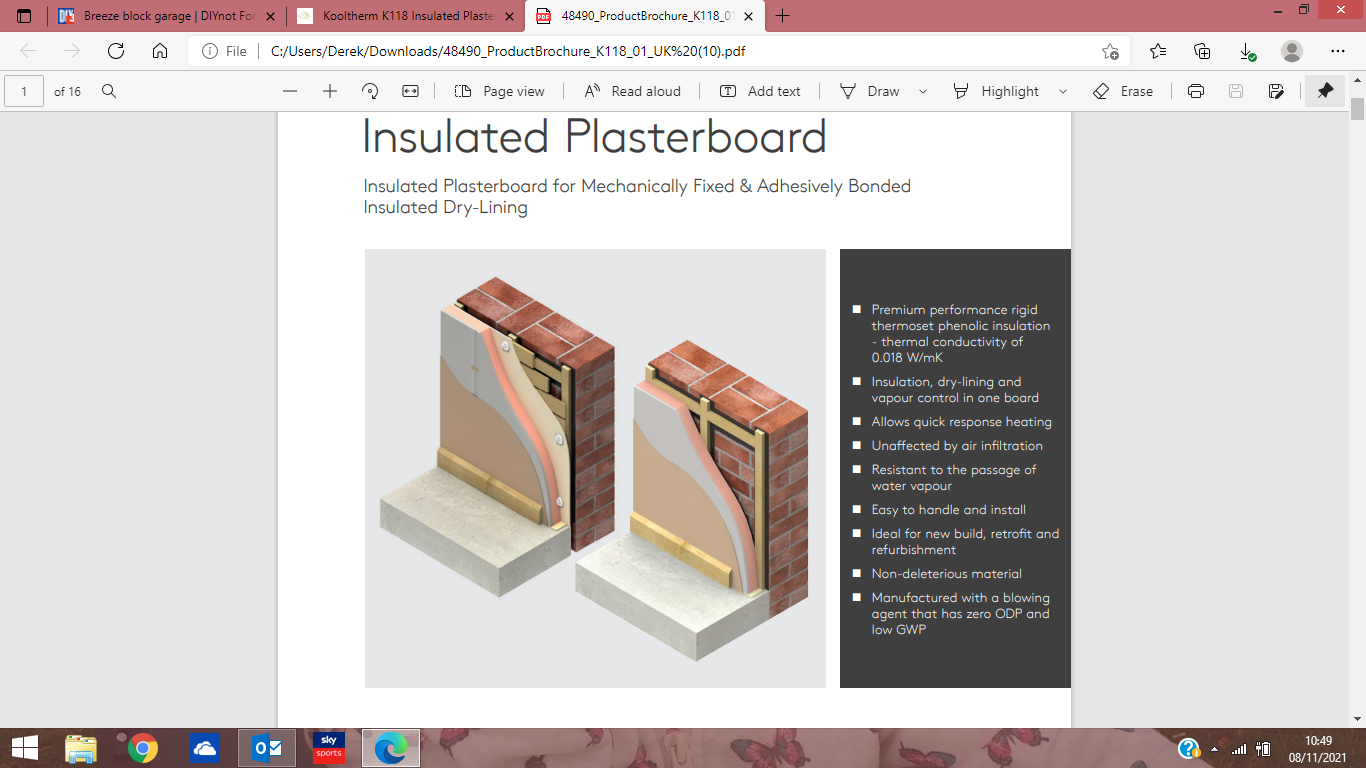

Its rendered so moisture should not be an issue not unlike the Kingspan K118 spec
