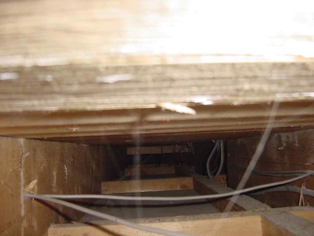

I'm part of the way through the lighting problem that we've already talked about (see Light Ring; Suspect wiring) I've spent the last couple of days off mapping the ccts (not bitter and twisted about that at all) and cant make sense of the system thats in place m8.
The simple way of putting it would be to send you a pic but i've not got a web site as you've already told you. Could you do me a favour and send an email to the addy on my profile and i'll send you the pics of the plans.
I will understand if thats asking too much m8 so i'll explain the dilema:
I've mapped the light ccts in about 90% of the house, All the ceiling roses have two black to the nuetral side and one red to the other. I've mapped the blacks and they form a chain from the first to the last ceiling rose. I havn't mapped the individual switching (reds) yet that will be this week. Its lovely this juggling shift work, two kids, she who must be obeyed and the nights are fair drawing in so no lnatural light to play with.

...All the ceiling roses have two black to the nuetral side and one red to the other. I've mapped the blacks and they form a chain from the first to the last ceiling rose.
You're right - that doesn't make sense at all. The wiring should form a chain from one rose to the next, so if you ignore the conductors for the switches and the light fitting itself, there would normally be two blacks on the neutral connector (one in, one out) and two reds (one in, one out).

sounds like its wired like council houses....
neutrals at fitting, lives taken to the switches first then switch wire upto the fitting.. is the lighting circuit wired in singles / conduit.
IL78,
Funny you should say that m8, the house was a council house, and its wired with singles but not in conduit. I take it you mean by singles, single red with twisted core along wit (but seperate) single black with core.
I'm dying to find out wot the :£$%^^ will be the end of this....i just know its going to be easier to rewire.

You can see from the pic taken under the eaves that the lighting cct is made up of single reds and blacks sheaved in grey going around the house voids....worrying!!!
If you zoom into the pic you'll see a conglomeration of cables all going into choc-block in the distance....again worryingly in possibly the hardest part of the house to access.
IL78 could you please explain a bit more about the wiring, given the lighting and switch plan, although its not finished as yet...i've only mapped the neutral lines so far. Does that corrospond to anything in your experience?
