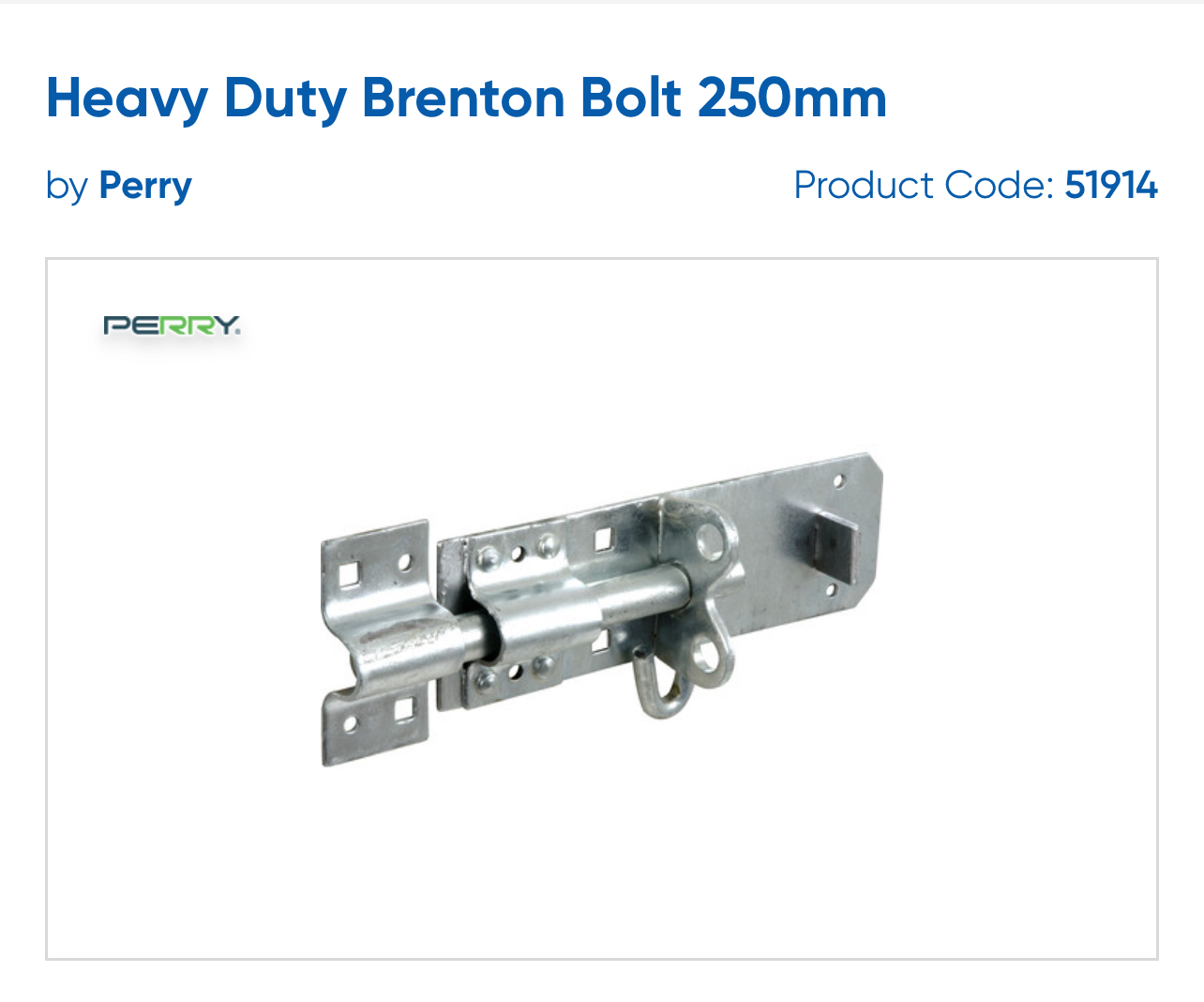

Looking to use these heavy duty bolts for a pair of shed doors:

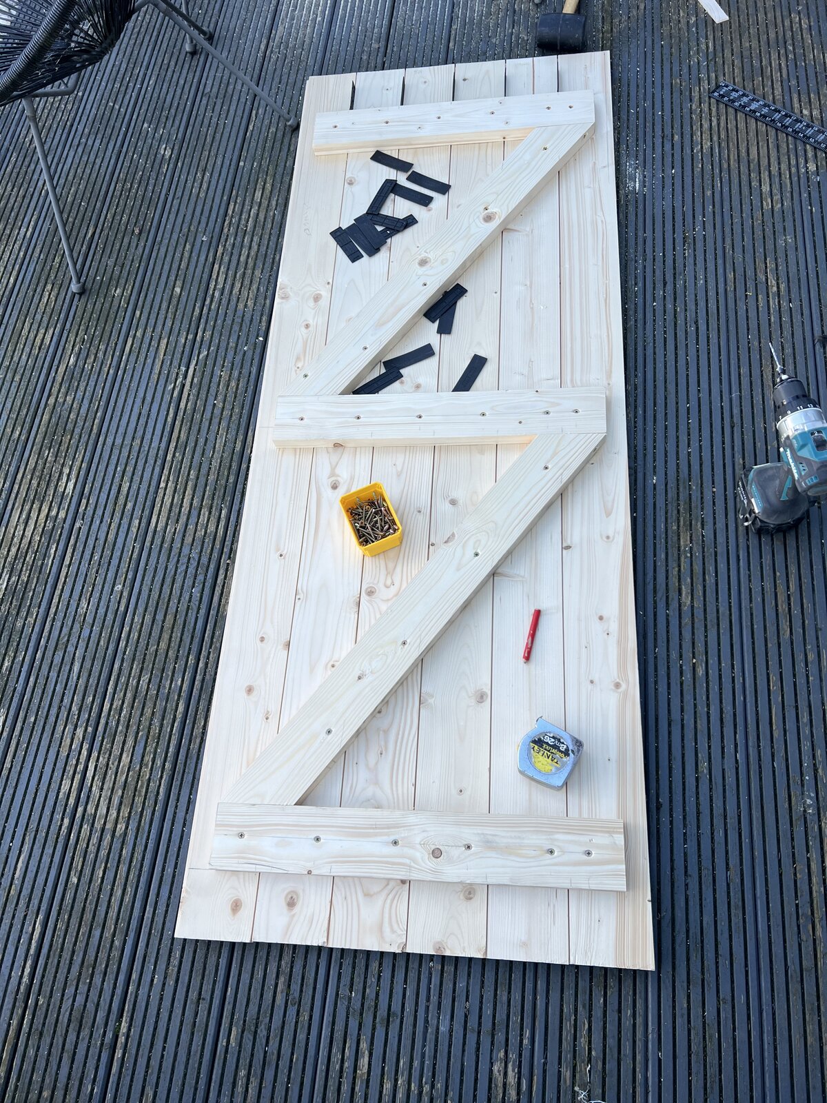

The two doors are constructed in this way:
I have left a 6mm gap between door and frame and 5mm where the two doors meet.
I wanted to check if I need to take any specific measures to cope with the misalignment of this bolt when doors expand/contract.
Also, is it good practice to put the latch section on the door that opens first?
Thanks in advance.
You may be surprised how easy it is to break these bolts......thieves hammer off the piece with the two holes and in they go.
Are there any alternatives you are considering?
Keep the bolt back from the timber edge in case that edge needs a touch with a plane.
Put the hinges on the edges from where the braces rise, and fit the bolt and keep when the door is hung successfully.
I thought the heavy duty version may be stronger than that? Also, I had a squire padlock which I’ve been happy with. I could get another one of these for my second door and have it working with the same key. Would you suggest an alternative?
I was thinking that the hinge will go on the central brace?
Three tee hinges perhaps?
The diagonal braces should rise from the hinge, ideally and one on the centre.
These bolts are held together by a riveting principle and as the bolt backplates are pretty thin, then so are the rivets! I’ve replaced quite a few due to people just levering them apart.

On a pair of doors, one of them will need internal sliding bolts top and bottom. Brenton bolts (padbolts) can't hold a pair of doors shut on their own.
I would say a heavy galv hasp and staple is slightly more secure, but you could still cut straight through it with a battery grinder
