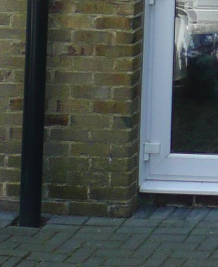

Hi there...
I've been thinking about cleaning up the bricks on my house.... it's a 1960's place and the bricks are a yellow type. I've had a builder around today for another job and he suggested using Brick Acid... he said the bricks were really good/nice but were soft and so care had to be used (I mentioned about sandblasting which he advised me against).
I've had a look around and seen 36% Hydrochloric Acid being sold for brick work.... this apparently diluted in a 4-1 solution and sprayed onto a wet wall...
The brick work is just dirty really, road grim, smoke etc... the mortare is also quite soft and crumbly in places so I don't rerally want to find myself with a huge repointing job as well.
Any suggestions on using this stuff to get the best results...
As an example I have attached a picture of a small section of the brickwork to be treated...
Many thanks
"Brick acid" is for cleaning cement stains, not general purpose brick cleaning.
It works by eating the cement away, so is not something to be used willy-nilly unless you want to be repointing in a few years time
What would you suggest would be the best way to destain these bricks then?
Detergent or algae remover/fungicide

Thanks for the suggestion... I wonder how this would deal with just general ground in dirt and dust though. There isn't any algae growth that I can see on the bricks.
Around the DPC is a small amount of Algae/Moss but on the surface of the bricks they look more "sooty" not all the bricks are like this... some have a more yellow appearance... maybe it is just the way the bricks are... perhaps they were reclaimed or something... I have no idea.
Just tested some 10% Hydrochloric Acid/patio/wall cleaner I remembered I had in the garage... that hasn't done much... apart from make the mortar very soft... think I might just have to put up with it or just render the lot.

Your ground level is a bit high (only a course to DPC) which can cause a bit of green on your brickwork through rain bounce.
